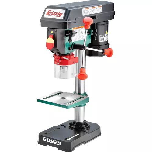

G0925 8" Benchtop Drill Press
A compact and versatile benchtop drill press.
The Grizzly G0925 Benchtop Drill Press is compact with an 8" swing and powerful enough to drill through metal, wood, and other materials. With a cast-iron base, it is remarkably stable for such a compact drill press, yet light weight and portable at just 34 lbs.
This benchtop model will complement your big floor press that’s too big to set up for quick, little jobs such as drilling a few holes for a scroll saw pattern or other small projects. Perfect for the Etsy crafter looking for the precision that a cordless drill simply can’t offer.
The 1/3 HP motor smoothly and quietly powers the 5-speed drill press from 740 to 3140 RPM. With a max drill capacity of 1/2" through cast iron or mild steel, it can easily drill through fiberglass, plastic, and composites.
The JT33 keyed drill chuck is fitted to the JT33 spindle taper. The chuck accepts drill bits as small as 1/16" to 1/2" to meet the needs of your various projects. The spindle has a 2" of travel as indicated by the depth scale conveniently mounted on the headstock. You can set the adjustable depth stop for predetermined and repeatable drilling.
The precision-ground cast iron table is 6-1/2" square and tilts 45° left and right. It swivels 360° around the steel column and has two 5/8" T-slots, 4-3/8" on center. The table height lock handle allows for easy adjustability up, down and around the column.
The G0925 manual was written by our U.S.-based Technical Documentation Department and is packed with useful information. The complete and easy-to-read manual makes it easier to assemble and maintain your drill press.
