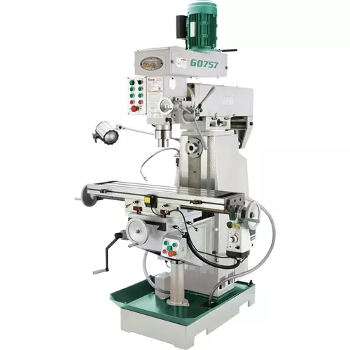

G0757 9" x 39" 2 HP Horizontal/Vertical Mill with Power Feed
This versatile machine allows you to perform both vertical or horizontal milling operations, with dedicated motors for each spindle.
Convert to the horizontal setup by rotating the head 180° on the column and installing either of the two included horizontal arbors.
Once in the horizontal configuration, you can do gang milling by installing multiple side and face mills on the arbor at one time, which ultimately can save huge amounts of time.
Besides the usual X, Y, Z-axis travel—the table also rotates 45° left and right—providing even more versatility and control for workpiece positioning and travel.
For vertical spindle positioning, the head tilts 90° left/right, swivels on the column, and has 11" of ram travel.
Additionally, this machine features a built-in coolant system, LED work light, and a wide range of spindle speeds.
With such a wide range of versatility and features, this machine could be one of the most functional machining centers in any shop!

- Vertical spindle motor: 3 HP, 220V, single-phase, 13A
- Horizontal spindle motor: 2 HP, 8.6A
- Vertical spindle speeds: 9, 285–2300 RPM
- Horizontal spindle speeds: 8, 72–1300 RPM
- Spindle taper: R-8
- Spindle travel: 5"
- Table size: 9-1/2" x 39-3/8"
- Table travel (longitudinal): 23-1/2"
- Table travel (cross): 8-1/2"
- Knee travel (vertical): 12-1/2"
- Table rotation: 45° L/R
- Head swivel: 180°
- Head tilt: 90° L/R
- T-slots: Three 5/8" slots, 3" on center
- Footprint: 35-1/2" x 20"
- Overall dimensions: 53-1/2" W x 54-7/8" D x 81-7/8" H
- Approximate shipping weight: 2050 lbs.
- Recycling coolant system
- Longitudinal power feed
- High-precision P5 spindle bearings
- LED work light
