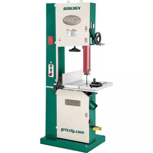

G0636X 17" 5 HP Ultimate Bandsaw
Designed to compete directly against expensive high-end European bandsaws.
After several years of research and development, we put together this amazing package that is a perfect blend of precision and muscle.
The G0636X 17" 5 HP Ultimate Bandsaw has all the features (and more) of comparable saws, but weighs nearly twice as much, meaning much more rigidity and vibration-absorbing mass than other 17" bandsaws.
The 5 HP motor powers through wood at a maximum 16" cutting capacity and the 16-1/2" throat is big enough for most applications.
The G0636X has an extra-wide 21" x 25-1/2" cast-iron table that can tilt from 5° left to 45° right. The cast-iron fence includes an extruded-aluminum resaw fence that attaches quickly and supports tall stock exceptionally well.
