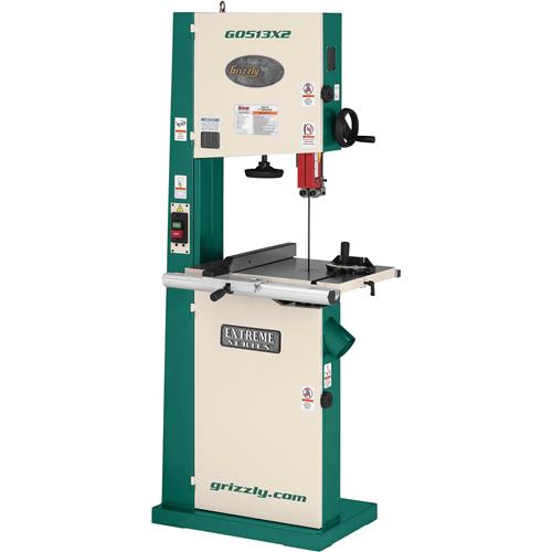

G0513X2 17" 2 HP Wood Bandsaw
From top to bottom, this woodcutting bandsaw is built to perform.
The G0513X2 17" 2 HP Bandsaw features a heavy-duty cast-iron trunnion and double ball-bearing blade guides usually only found on machines costing much, much more.
The 2 HP motor powers through hardwoods with a 12-1/8" cutting height and 16-1/4" throat provide ample cutting capacity for most applications. For a full range replacement and resaw blades for your G0513X2, click here.
The G0513X2 has a large 23-5/8" x 17-1/4" cast-iron table that can tilt from 5° left to 45° right. A cast-iron fence with extruded-aluminum rail and resaw fence attachment mount to the table.
Power and capacity are just a part of why owners continue to give this bandsaw a solid 5-star rating.
The stout steel frame houses the heavy computer-balanced cast-iron wheels designed to minimize vibration during resaw operations.
This machine is prewired to operate on a 220V power supply circuit that has a verified ground and meets the 220V operation requirements. If you prefer 110V, refer to the Voltage Conversion instructions in the manual.
The G0513X2 manual was written by our U.S.-based Technical Documentation Department and is packed with useful information. The complete and easy-to-read manual provides full instructions on how to assemble and maintain your bandsaw.
