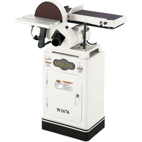

W1676 Shop Fox 6" Belt / 10" Disc Combo Sander
A professional-grade sander supplying professional results.
The W1676 6" Belt / 10" Disc Combo Sander from Shop Fox bridges the large gap between the bench-top models and the more expensive industrial models.
The 6" x 48" sanding belt tilts 90° and can be used in both horizontal and vertical positions, or any angle between, based on your needs. A full range of replacement belts are available.
The back stop supports workpieces on the belt sander in any position.
The 6"-wide by 12-1/4"-long cast-iron worktable tilts from 0° left to 45° right and supports workpieces when using the 10" sanding disc. Replacement PSA sanding discs are available in a variety of grits.
A built-in storage shelf holds plenty of replacement belts and discs.
The W1676 manual was written by our U.S.-based Technical Documentation Department and is packed with useful information. The complete and easy-to-read manual provides full instructions on how to assemble and maintain your sander.
  • Motor: 1 HP, 110V/220V, prewired 110V, single-phase, 14A/7A
  • Sanding belt size: 6" x 48"
  • Sanding belt speed: 1900 FPM
  • Belt sanding head tilt: 0–90°
  • Platen size: 6-1/4" x 17"
  • Sanding disc diameter: 10"
  • Sanding disc speed: 2420 RPM
  • Sanding disc type: PSA
  • Disc sanding table size: 6" W x 12-1/4" L
  • Disc sanding table tilt: 0°–45°
  • Number of dust ports: 2
  • Dust port sizes: 2" and 2-1/2"
  • Footprint: 15" x 16-1/2"
  • Overall size: 30" W x 24" D x 56" H
  • Approximate shipping weight: 168 lbs.
  • Two-year warranty!!
  • 10" computer-balanced cast-iron disc
  • Quick-change belt release
  • Cabinet-style stand with powder-coated finish
  • Heavy-duty miter gauge
  • Graphite-coated platen
  • Ball bearing construction
  • 2" and 2-1/2" Dust ports
