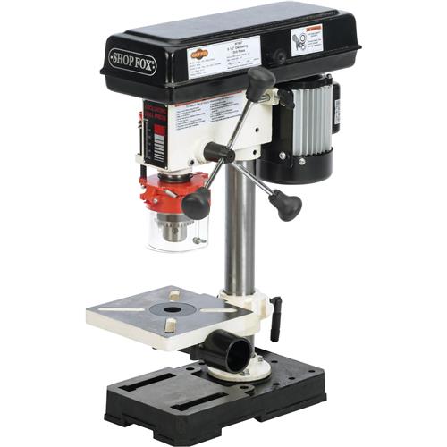

W1667 8-1/2" Benchtop Oscillating Drill Press
A benchtop drill press with the ability for oscillating contour sanding.
The Shop Fox W1667 8-1/2" Oscillating Drill Press is both a drill press and an oscillating sander in one compact machine.
The W1667 is fitted with a JT33 keyed drill chuck, offers up to 2" of travel and a drilling capacity of 1/2" through mild steel.
The 1/2 HP motor smoothly powers the five spindle speeds ranging from 550 to 3000 RPM.
A sanding spindle is included for use with drums ranging in size from 1" to 2" in diameter and is 4-1/4" long.
Purchasing additional drums and sleeves will allow you to sand small or finely detailed pieces.
With the oscillating feature, your abrasives will last longer and provide a better finish.
The 7" by 7" table allows surfaces to be sanded at many different angles as it tilts 90° in both directions.
Included are table inserts to give maximum support for the workpiece and a dust port for connection to your dust collection system.
Within a small footprint, this is drill press packs a ton of functionality, yet won't take up space.
