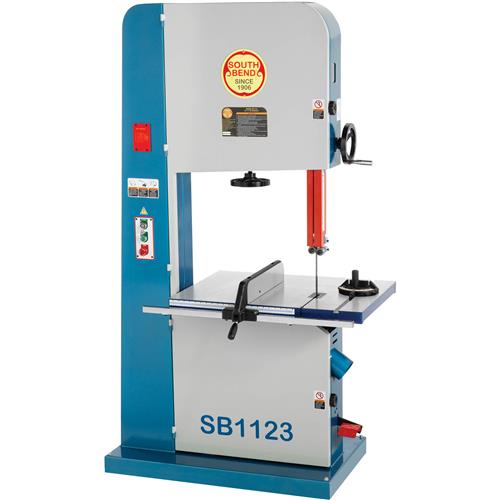

SB1123 24" Industrial-Duty 7-1/2 HP Resaw Bandsaw
Precision, power, and capacity for high-output, industrial use.
The professional-level, high-production SB1123 24" Industrial-Duty 7-1/2 HP Resaw Bandsaw from South Bend is a top-end powerhouse with its massive 24-3/8" throat and 16-1/8" resaw capacity, powered by a 7-1/2 HP motor.
It’s the largest capacity, most impressive wood-cutting bandsaw South Bend offers–built to meet the demanding needs for industrial production work.
Dual ball-bearing blade guides and rack-and-pinion table adjustments provide precision and ease of use.
The computer-balanced cast-iron wheels, an extra-large 23-5/8" by 33-1/2" x 2" thick precision-ground cast-iron table, and cast-iron trunnions all work together to minimize vibration.
The table tilting mechanism is the strongest in the industry, allowing you to put the heaviest loads on the table without losing squareness. This saw is a true joy to use!
