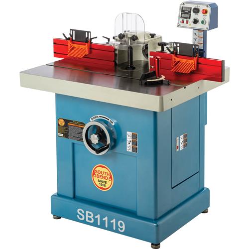

SB1119 3 HP Single-Phase Spindle Shaper
Gain the advantage with industrial capacity in a high-end shaper.
The 3 HP spindle shaper will give you superb finishes with high-end features and precision-built quality only available from South Bend.
Each model has a digital readout for precise spindle speed and height adjustments, and a micro-adjustable fence with featherboards.
You’ll get maximum support for large workpieces plus versatility with a solid 3-3/8" thick, 31-1/2" x 39-1/4" precision-ground cast-iron table that accepts cutters up to 7" in diameter.
Additional features include dual dust ports, an included miter gauge, and a fully adjustable clear guard.
Where quality and high output matter, choose South Bend for dependability, accuracy, and versatility and then watch your production soar!
CSA certified
  • Required power source: 230V, single-phase, minimum 20A circuit
  • Motor: 3 HP, 230V
  • Maximum cutter height: 5"
  • Maximum cutter diameter: 7"
  • Spindle diameters: 3/4", 1-1/4"
  • Spindle lengths: 3-7/8" and 5-7/8"
  • Spindle capacities under nut: 3-1/2" and 5-1/8"
  • Spindle speed: Variable, 5000–10,000 RPM
  • Spindle travel: 4"
  • Spindle openings: 2-1/2", 4-1/8", 5-3/4", 7"
  • Table counterbore: 8-1/4"dia., 3/16" depth
  • Table size: 31-1/2" x 39-1/4"
  • Floor-to-table height: 36-5/8"
  • Footprint: 25-1/2" x 31"
  • Dimensions: 39-1/2" W x 34" D x 51-1/2" H
  • Approximate shipping weight: 780 lbs.
  • 2-year limited warranty
  • DRO for spindle RPM and height positioning
  • 4-3/4" tall anodized aluminum fence with featherboard attachments
  • Rack-and-pinion fence adjustment with 4" of travel
  • Micro-adjustment knobs for fence alignment
  • Power feeder attachment locations (power feeder not included)
  • Variable speed, from 5000–10,000 RPM
  • Fully adjustable clear guard
  • Dual 4" dust ports
  • Quick-release belt tensioner
