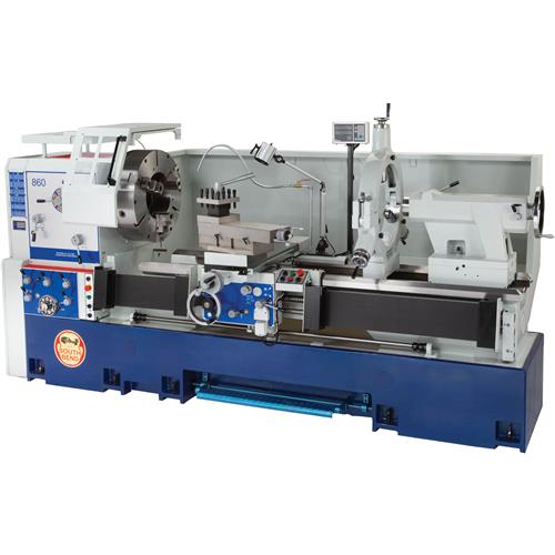

Image for South Bend SB1065F - 34" x 72" Big Bore Lathe, 9" Bore

SB1065F 34" x 72" Big Bore Lathe
A high-torque 34" lathe providing maximum cutting power.
With a 34-inch swing and 72-inch distance between centers the SB1065F South Bend Big Bore Lathe is custom-designed and built to tackle demanding industrial applications and large-diameter workpieces with ease. From oil pipes to hydraulic cylinders, this lathe delivers superior cutting force, enhanced stability, and uncompromising quality for rugged industrial use.
  • Massive 9" Spindle Bore
  • Dual Spindle Noses
  • 30 HP Spindle Motor
  • Meehanite® castings with induction-hardened ways
  • SKF German Spindle Bearings
  • 2-Speed Tailstock
  • 3 V-way bed
Customized for Your Specific Needs
Every SB1065F lathe comes equipped ready for production from the factory. Knowing production environments vary, we offer a range of accessories and components, ensuring your machine is perfectly suited for your specific applications.
We have optional accessories available you can choose from, such as an outbound chuck, double steady rest, or different size faceplates. It's recommended that you review and add any additional accessories at the time of purchase as they are custom fitted at the factory so your machine is ready to use upon delivery. Build the complete machine for your shop by selecting your custom options.
INCLUDES:
  • (1) 25" 3-Jaw chuck
  • Fagor Digital Readout
  • 20" Steady rest with roller tips
  • Chuck guard with limit switch
  • Lead screw cover
  • Micro carriage stop
  • Work Light
  • Rear splash guard
  • 4-Way tool post
  • Toolbox with tools
  • Spindle motor: 30 HP, 230V/460V, 3-phase, 69.3A/34.7A
  • Feed motor: 1/4 HP, 2.1A/1.05A
  • Coolant pump motor: 1/8 HP, 0.23A/0.12A
  • Swing over bed: 34"
  • Distance between centers: 72"
  • Max weight between centers: 2992 lbs.
  • Swing over cross slide: 24"
  • Swing over gap: 48"
  • Max tool bit size: 1-1/4"
  • Compound travel: 13"
  • Carriage travel: 70-7/8"
  • Cross slide travel: 18-7/8"
  • Spindle nose: A2-15
  • Spindle bore: 9"
  • Spindle taper: MT#7, 1/20 OPT
  • Spindle speeds: 12, 6–500 RPM
  • Floor to spindle center height: 46-1/2"
  • Tailstock taper: MT #6
  • Tailstock quill travel: 10"
  • Tailstock barrel travel: 4"
  • Inch threads: 36, 2–28 TPI
  • Metric threads: 38, 0.8–14mm
  • Longitudinal feeds: 36, 0.02–0.27"/rev
  • Cross feeds: 36, 0.01–0.14"/rev
  • Modular pitches: 15, 0.4–7
  • Diametral pitches: 36, 4–56
  • Leadscrew diameter and pitch: 1-13/16" x 2 TPI
Our U.S.-based Technical Documentation Department produces detailed owner's manuals and instruction sheets, empowering your team to optimize equipment performance and minimize downtime.
Comprehensive U.S.-Based Support:
Our experts provide a full range of support services, including troubleshooting, maintenance tips, and parts sourcing, ensuring your equipment's optimal performance. The 2-year warranty on the SB1065F safeguards your investment, offering peace of mind and ensuring long-term reliability.
