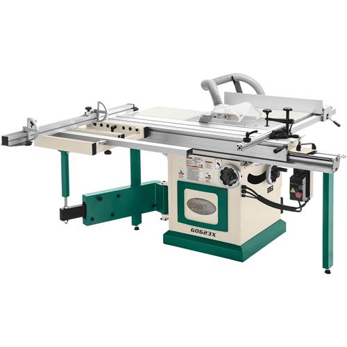

G0623X 10" 5 HP Sliding Table Saw
A sliding table saw for those with limited shop space.
The G0623X 10" Sliding Table Saw perfectly blends traditional table saw functionality with easy-to-use sliding table ripping and saw cross-cutting capability.
The G0623X allows full-sheet cutting capacity for crosscuts and miters, plus the added benefit of 33" of ripping capacity.
The scoring blade pre-scores the material, minimizing tear-out for a smooth, professional finish. The material then follows through the 10" main blade for a clean, precise cut.
The dust shroud has a 2-1/2" dust port that connects directly to the riving knife mount to keep the cutting area clean during operation.
The compact but heavy-duty aluminum 12-1/4" x 63" sliding table travels on ball-bearing guides for an effortless cutting action.
The 2" tall crosscut fence extends up to 78-3/4" to evenly support your workpiece and allows for cross cutting pieces up to 63" wide.
For miter cuts, simply rotate the fence assembly and lock it in place for miters up to 48" wide when set at 45°.
