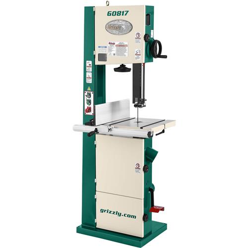

G0817 14" Super HD 2 HP Resaw Bandsaw with Foot Brake
This award-winning heavy-duty bandsaw features an industry-leading 14" resaw capacity!
The G0817 14" Super HD 2 HP Resaw Bandsaw was awarded Top Tool by WOOD Magazine for its performance and combination of features over the competition.
The 2 HP motor powered through 14"-wide cuts–the widest in the test–without bogging down.
With its cast-iron fence with 2-position, 6" tall resaw fence, and solid one-piece reinforced steel frame, this machine will plow through anything you can throw at it.
The handwheel-operated rack-and-pinion upper guide post and lever-action rack-and-pinion table tilt allow for quick and easy adjustments for all types of cuts.
Get the ultimate in bandsaw versatility with the modular blade guide system, allowing you to easily switch between guides in no time! For a full range replacement and resaw blades for the G0817, shop here.
The G0817 features a foot brake that also acts as a safety device and can bring the machine to a quick stop.
This saw is also equipped with heavy-duty cast-iron wheels, table, and trunnion, built-in blade storage, and dual 4" dust ports to provide nearly perfect dust collection.
  • Motor: 2 HP, 110V/220V* (prewired 110V), single-phase, 19A/9.5A
  • Cutting capacity: 13-1/2" left of blade
  • Resaw capacity: 14"
  • Table size: 16-1/8" x 21-3/4"
  • Table tilt: 5" left, 45" right
  • Floor-to-table height: 37"
  • Blade size: 120" (1/8"–3/4" wide)
  • Blade speed: 2820 FPM
  • Footprint: 24" x 18"
  • Overall dimensions: 29" W x 32-1/2" D x 76" H
  • Approximate shipping weight: 388 lbs.
  • Modular blade guide system for easy changeovers between styles
  • Foot-operated brake system
  • Quick-release for blade tension
  • Blade tension and tracking windows
  • Built-in blade storage area
  • Cast-iron wheels, table, and trunnion
  • Dual 4" dust ports
  • Key-lock master power switch
  • Ball-bearing upper and lower blade guides
  • Miter gauge
