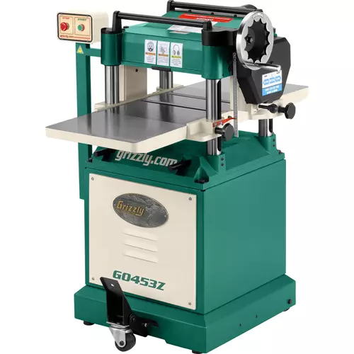

G0453Z 15" 3 HP Planer w/ Spiral Cutterhead
Upgrade to a spiral cutterhead with power to spare.
The G0453Z 15" 3 HP Planer w/ Spiral Cutterhead recognized ahead of the rest of the 15" planers tested by WOOD Magazine for its combination of clean cuts and the ability to control snipe.
The 4-row spiral cutterhead with 74 German-made indexable carbide inserts cut some of the finest surface finishes money can buy.
Each insert can be rotated up to three times to expose a new sharp edge for superior finish.
Reducing the cut to the size of a single insert makes for a cleaner cut and reduces noise compared to the traditional straight knife cut.
The 3 HP motor spins the cutterhead at 4800 RPM to plane your stock up to 15" wide by 8" thick, cutting as deep as 1/8" per pass.
Additionally, the G0453Z features a built-in mobile base, adjustable bed rollers, two-speed automatic board feed, and solid cast-iron extension wings.
Like all Grizzly planers, the G0453Z comes with a 1-year warranty which covers parts and assures the unit is free from factory defects. (Consumables are not covered by the warranty.)
The G0453Z manual was written by our U.S.-based Technical Documentation Department and is packed with useful information. The complete and easy-to-read manual makes it easier to assemble and maintain your planer.
The Grizzly Customer Service and Technical Support Teams are also U.S.-based. Parts for the planer may be available online and shipped from the Grizzly parts warehouse in Springfield, MO.
CSA certified
Note on replacement inserts:
  • Models manufactured April 2015 and later use H7319 (74) 14mm x 14mm x 2.0mm replacement inserts.
  • Models manufactured March 2015 and earlier use T21348 (74) 14.17mm x 14.17mm x 2.0mm replacement inserts.
  • Motor: 3 HP, 240V, single-phase, 15A
  • Maximum stock width: 15"
  • Maximum stock thickness: 8"
  • Minimum stock thickness: 3/16"
  • Minimum stock length: 8"
  • Maximum cutting depth: 1/8"
  • Cutterhead diameter: 3"
  • Cutterhead type: 4-row spiral, 74 inserts
  • Cutterhead speed: 4800 RPM
  • Feed rate: 16 & 30 FPM
  • Table size: 15" x 42"
  • Dust port size: 4"
  • Footprint: 22" x 22-1/2"
  • Overall dimensions: 32-1/2" W x 42" D x 45-7/8" H
  • Approximate shipping weight: 672 lbs.
  • Board return rollers
  • Pedestal-mounted control panel
  • Built-in mobile base
  • Adjustable bed rollers
  • Rubber-coated outfeed roller
  • Built-in lifting rods
  • Angled dust port hood
  • Four-column support with table locks
  • Precision-ground, cast-iron table and extension wings
  • Heavy-duty cast-iron construction
