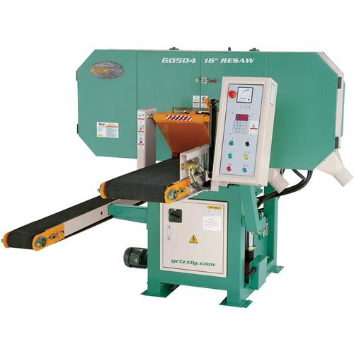

Grizzly G0504 - 16" 30 HP 3-Phase Dual Conveyor Horizontal Resaw Bandsaw
5.0 (1)
$28,775.00
G0504 16" 30 HP 3-Phase Dual Conveyor Horizontal Resaw Bandsaw
Maximize lumber yield and boost manufacturing productivity.
This resaw is popular with lumber yards and manufacturers working with veneers. It's capable of resawing large quantities of wood quickly.
The operation controls, including cut thickness and conveyor speeds, can be easily worked by the primary operator.
The digital controller allows for four pre-set height/thickness selections at the press of a button. Once a thickness is set, different sizes of lumber can be fed in without further adjustments.
The powerful 30HP motor combined with the thin kerf blade cuts through hardwoods like butter. The resaw can cut as thin as 1/16" and has the capacity to cut materials up to 16" wide x 10" tall x 12' long. The cuts are clean and leave minimal saw marks reducing processing time.
Setting the hydraulic blade tension is simple and the infeed and return conveyors are adjustable. Changing the blade takes less than 2 mins.
Ceramic blade guides improve accuracy and improve blade life while keeping the blade clean and cool.
*This machine is prewired for 220V. We can rewire to 440V in a few days’ time for a fee. Please contact Grizzly Technical Support at (570) 546-9663 before placing your order.
  • Main motor: 30 HP, 220V/440V* (prewired for 220V), 3-phase, 72.9A/36.4A
  • Elevation motor: 1/2 HP, 1.94A/0.97A
  • Minimum circuit size: 100A @ 220V, 50A @ 440V
  • Hydraulic pressure: 1000 PSI
  • Maximum cutting capacity: 10" x 16"
  • Distance from blade to conveyor table: 1/4"–10"
  • Feed speed: Variable, 0–61 FPM
  • Saw blade size: 180" L x 1" W
  • Saw blade speed: 7300 FPM
  • Floor to table height: 40"
  • Infeed table: 106" L x 16" W
  • Infeed belt: 215-3/4" L x 15-1/4" W
  • Return table: 107-1/2" L x 18-1/2" W
  • Return belt: 215-3/4" L x 7-1/4" W
  • Wheel size: 28" dia. x 7/8" W
  • Dust port size: 2 x 4"
  • Footprint: 45-1/4" x 32-1/4"
  • Overall size: 85" W x 108" D x 83-1/2" H
  • Approximate shipping weight: 4325 lbs.
  • Digital height control for accurate blade positioning
  • Variable-speed, hydraulically-driven feed and return conveyors
  • Powered saw elevation
  • Hydraulic blade tensioning with gauge
  • Adjustable ceramic blade guides
  • Steel conveyor table
  • Steel fence with rollers
  • 4" Cast-iron pressure rollers with polyurethane tires
  • 1-year limited warranty
