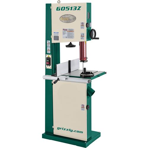

Grizzly G0513Z - 17" 2 HP Bandsaw w/ Resaw Fence & Bar

G0513Z 17" 2 HP Bandsaw with Resaw Bar
Streamline your wood-cutting with this precision bandsaw offering exceptional resaw control.
Featuring a two-position resaw fence and an adjustable resaw bar, the G0513Z lets you “steer” workpieces through the blade while maintaining support from the fence. This gives you outstanding control and accuracy when resawing or making thick cuts—perfect for creating veneers, making thin stock for inlays, or cutting book-matched panels.
The 2 HP motor powers through the thickest of cuts, and the 16-1/8" throat offers and plenty of room to position your workpiece. This machine comes with a 1/2" - 6TPI Raker blade installed.
The precision-ground cast-iron table with geared micro-adjustable tilt lets you dial in the exact bevel you need with absolute precision.
The G0513Z is the perfect saw for small to medium size shops and serious hobbyists looking to up their woodworking game.
Key Features:
  • Two-Position Resaw Fence: Lets you quickly switch from cutting thick stock and resawing applications to cutting thin and narrow workpieces.
  • Resaw Bar: Allows you to “steer” your workpiece while maintaining support from the fence, helping you stay on your line and prevent blade wander.
  • Precision-Ground Cast-Iron Table: Provides absolute flatness and stability for reliable accuracy.
  • Geared Micro-Adjustable Table Tilt: Lets you easily set any bevel with total precision.
  • Heavy-Duty Miter Gauge: Cut accurate miters and compound angles with the included miter gauge, designed for precision and long-lasting durability.
  • Quick-Release Blade Tension Lever: Allows you to instantly release the blade tension for faster blade changes.
  • Blade-Tracking Window: Provides a view of the blade on the wheel when making tracking adjustments.
  • Euro-Style Roller Disc Guides: The professionals’ choice—these guides offer increased blade stability, due to greater contact between the guides and the blade.
  • Motor: 2 HP, 110V/220V (prewired 220V), single-phase, 20A/10A
  • Throat (max. width left of blade): 16-1/8"
  • Resaw height: 12-1/8"
  • Blade size: 131-1/2" (1/8" - 1" wide)
  • Blade speeds: 1700, 3500 FPM
  • Blade guides: "Euro-style" roller disc
  • Fence size: 6" H x 23" L
  • Table size: 17" x 17"
  • Table tilt: 10° left, 45° right
  • Floor to table height: 37-1/2"
  • Footprint: 27" W x 18" D
  • Overall dimensions: 32" W x 32" D x 73" H
  • Approx. shipping weight: 364 lbs.
