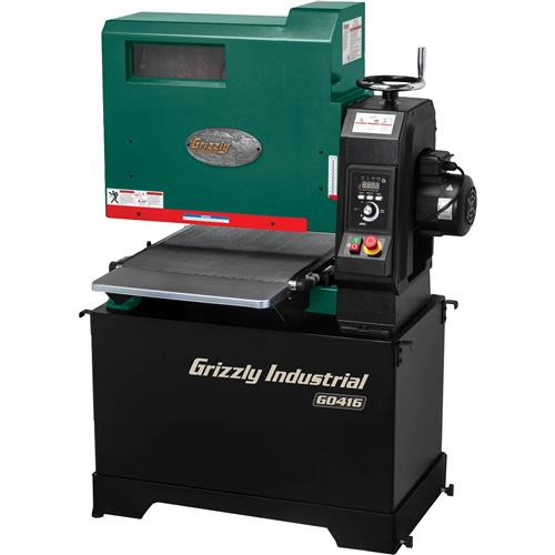

G0416 20" 3 HP Open-End Wide-Belt Sander
Expand your sanding capacity and improve consistency with this affordable wide-belt sander.
This open-end sander is the perfect choice for small shops looking for an economical way to maximize sanding efficiency.
A digital display helps ensure accurate height adjustments for every sanding run, and the variable-speed, heavy-duty conveyor is adjustable based on material type and thickness.
The 3 HP wide-belt sander's open-end design provides flexibility for processing boards up to 40" wide with speed and precision, and a "G-Sense" automatic function controls machine amps to protect from excessive current.
A specialized plenum chamber evenly distributes airflow and stablizes pressure for efficient dust removal, reducing clogging and improving overall collection performance.
Additional features include a mobile base for convenient movement, a conveyor viewing window, and LED lights for enhanced visibility.
Our 20" open-end wide-belt sander is competitively priced and ready to support your shop with exceptional quality results for panels, doors, tabletops, and additional workpiece types.
FEATURES & BENEFITS:
  • Digital Display: View material height in inches/mm and adjust as needed.
  • Variable-Speed Conveyor: The durable rubber conveyor belt is adjustable between 0-20 FPM.
  • Open-End Design: Allows you to sand wider than the drum (up to 40”) by flipping your workpiece around and running a second pass.
  • "G-Sense" Load Sensing and Auto-Adjust Function: Prevents overload by automatically adjusting feed rate when excess load is detected.
  • Dust Collection: Uses an air channel (called a plenum chamber) to provide consistent, even airflow to efficiently capture dust.
  • Stand with Storage: Features a built-in stand with footpads and a compartment with a shelf for storing sanding belts.
  • Bi-Directional 4" Dust Port: Offers versatility to suit your dust collection setup.
  • Viewing Window: Allows for easy monitoring of sandpaper belt tracking.
  • LED Lights: Mounted inside for better visibility during belt changes or maintenance.
  • Main motor: 3 HP, 230V, single-phase, 12.5A
  • Conveyor motor: 65W, 0.48A
  • Maximum board width: 40"
  • Maximum board thickness: 4"
  • Minimum board length: 8"
  • Sanding belt size: 48" L x 21" W
  • Sandpaper speed: 2800 FPM
  • Sanding belt oscillations per minute: 20
  • Sanding belt oscillation stroke length: 5/8"
  • Conveyor speed rate: 0-20 FPM
  • Conveyor table length: 21"
  • Dust port size: 4"
  • Footprint: 37-1/2" x 22"
  • Overall size: 43" L x 40" W x 60" H
  • Approximate shipping weight: 660 lbs.
Get professional sanding results without busting your budget with this 20" 3 HP open-end wide-belt sander.
