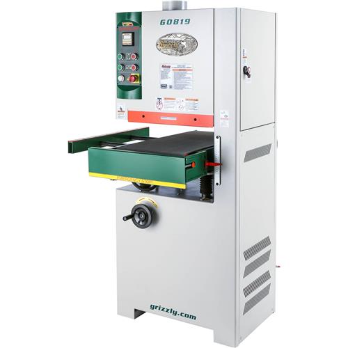

G0819 15" 5 HP Open-End Wide-Belt Sander
Double your sanding capacity within a small footprint.
The G0819 15" 5 HP Open-End Wide-Belt Sander is for those looking to maximize efficiency in their wood shop.
With a footprint of 19-1/2" x 27-1/2", this heavy-duty sander is capable of sanding a 30" wide workpiece in two passes. That’s a lot of capacity for a smaller sander!
It takes less than 30 seconds to change out the 16" x 48" sanding belts. A full range of replacement belts are available.
With a focus on rigidity and production work, the G0819 will have zero flex on a heavy pass. An adjustable side support slides out from the side of the machine, eliminating the need for aftermarket supports.
The three conveyor speeds of 16.4, 23, and 32.8 feet per minute allow for adjustment based on the type wood being sanded.
The G0819 has pneumatic oscillation speed control and a pulse-jet cleaning system to keep the electric oscillation sensor dust-free.
Other quality features such as an amp meter, micro-adjustable graphite-felt platen, and emergency stop plate makes this a high-caliber machine.
The G0819 manual was written by our U.S.-based Technical Documentation Department and is packed with useful information. The complete and easy-to-read manual makes it easier to assemble and maintain your belt sander.
