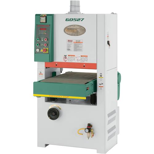

G0527 18" 5 HP Wide-Belt Sander
High-performance sanding made compact and affordable.
The Grizzly G0527 18" Wide-Belt Sander redefines what's possible in a compact and budget-friendly package. Here's what makes it stand out:
  • Unmatched Precision & Control: The digital control panel and four rubber pressure rollers ensure perfect sanding results on workpieces as small as 9" long x 1/8" thick, ideal for detailed projects.
  • Exceptional Performance: The powerful 5 HP motor delivers superior sanding power, while variable conveyor speeds (16-33 FPM) and a sanding belt speed of 3500 FPM optimize sanding for various materials.
  • Digital Convenience: Easily monitor key parameters with the digital control panel featuring an amp meter for precise operation.
Designed for Efficiency & User-Friendly Operation
  • Three Independent Motors: Dedicated motors for the sanding drum, conveyor belt, and table height adjustments provide optimal performance and control.
  • Disc Brake for Safety: The disc brake ensures quick and safe stopping whenever needed.
  • Pneumatic Belt Tensioning: Effortlessly maintain perfect belt tension for consistent sanding results.
  • Reduced Dust: The dustproof photoelectric eye and 4" dust port work together to maintain a clean work environment.
The G0527 includes 100- and 150-grit sanding belts. A full range of replacement belts are available.
An outstanding list of features at an amazing price make this one of the best deals on the wide-belt sander market!
  • Motor: 5 HP, 220V, single-phase, 30A
  • Conveyor feed motor: 1/2 HP, 7A
  • Elevation motor: 1/3 HP, 3A
  • Maximum board width: 17-1/2"
  • Maximum board thickness: 6"
  • Minimum board length: 9"
  • Minimum board thickness: 1/8"
  • Conveyor speed: 16, 23, 33 FPM
  • Sanding belt speed: 3500 FPM
  • Sanding belt size: 18-1/2" x 48"
  • Sanding belt oscillations: 1/2–5/8"
  • Air requirement: 57–75 PSI, 2 CFM
  • Footprint: 19-1/2" x 16-3/4"
  • Overall dimensions: 37" W x 30" L x 57" H
  • Approximate shipping weight: 1008 lbs.
