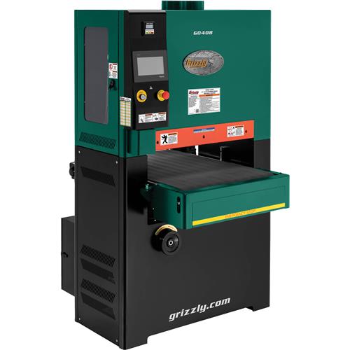

G0408 24" 10 HP Extreme Series Wide-Belt Sander
Robust sanding power in an adaptable wide-belt sander designed for production woodworking.
Get your professional woodworking shop up to full speed by adding this wide-belt sander to your equipment lineup.
Fitted with a high-powered 10 HP motor, the sander turns out top quality, consistently smooth workpieces so you can meet every deadline.
Special options on this 24" wide-belt sander include user-friendly touch-screen controls, thickness sensor, clear side window, and interior lighting.
This sander is ready to support your daily shop goals whether you are finish sanding before applying a topcoat, batch sanding multiple board feet, or ensuring smooth surfaces for joinery.
FEATURES & BENEFITS:
  • Touch screen controls for motors, sanding drum, conveyor, and table elevation
  • Material thickness sensor automatically adjusts the table to the thickness of your workpiece
  • Plexiglass side window and interior lights for easy viewing of sanding belt tracking
  • Variable-speed feed conveyor for adaptability and optimal sanding results
  • Pneumatic belt tracking and tensioning to maintain the perfect pressure for accurate sanding
  • Amp/load meter to prevent excessive loads while maximizing machine capacity
  • Built-in air regulator/water separator to protect pneumatic components
  • Rubber infeed and outfeed pressure rollers prevent uneven sanding and dampen vibration
  • Disc brake, emergency stop bar, and stop switch for optimal safety
  • Main motor: 10 HP, 220V, single-phase, 50A
  • Conveyor feed motor: 1 HP, 7A
  • Table elevation motor: 1/3 HP, 3A
  • Maximum board width: 24-3/8"
  • Maximum board thickness: 6"
  • Minimum board length: 10"
  • Minimum board thickness: 1/8"
  • Conveyor speed: 15-49 FPM
  • Sanding belt speed: 3500 FPM
  • Sanding belt size: 25" x 60"
  • Sanding belt oscillations: 35-40 OPM
  • Air requirement: 75 PSI
  • Footprint: 39-1/2" x 19-1/2"
  • Overall dimensions: 42" W x 50" D x 68" H
  • Approximate shipping weight: 1533 lbs.
