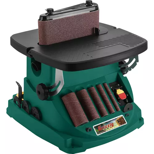

T27417 Oscillating Edge Belt and Spindle Sander
Two benchtop sanders in one!
Transform your sanding capabilities with the T27417. It seamlessly converts between an oscillating spindle sander and a 4" x 24" oscillating edge belt sander, tackling a wide range of sanding tasks.
Effortlessly sand intricate curves, outside edges, and both inner and outer workpiece contours with the oscillating spindle sander.
The innovative oscillating spindle movement minimizes burning, maximizes material removal, and extends sandpaper life compared to traditional sanders.
The 0-45° tilting table allows for angled sanding, while on-board storage keeps sanding sleeves, drums, table inserts, and the edge sanding attachment organized and readily accessible.
There is a full range of replacement sanding belts and sanding sleeves for the T27417.

SPECIFICATIONS
  • Motor: 1/2 HP, 120V, single-phase, 3.5A
  • Spindle speed: 2000 RPM
  • Spindle stroke: 5/8"
  • Spindle oscillations: 58 SPM
  • Spindle diameter: 1/2"
  • Sanding drum length: 4-1/2"
  • Sanding drum diameters: 3/4", 1", 1-1/2", 2"
  • Sanding belt speed: 1575 FPM
  • Sanding belt dimensions: 4" x 24"
  • Platen dimensions: 4" x 6-1/8"
  • Table size: 16-1/4" x 16-3/4"
  • Table tilt: 0–45°
  • Table: Cast aluminum
  • Dust port size: 1-1/2"
  • Footprint: 16-1/2" x 18-1/2"
  • Overall dimensions: 16-1/2" W x 18-1/2" D x 18-1/2" H
  • Approximate shipping weight: 32 lbs.
FEATURES
  • Quickly converts from spindle sander to edge belt sander
  • 0–45° Tilting table with detents at 0°, 15°, 22.5°, 30°, and 45°
  • Built-in storage for sanding sleeves, sanding drums, table inserts, and edge sanding attachment
INCLUDES:
  • (4) 4-1/2" Long sanding drums with table inserts: 3/4", 1", 1-1/2", 2" diameter
  • (5) 80-Grit sanding sleeves: 1/2", 3/4", 1", 1-1/2", 2" diameter
  • (1) Edge sanding attachment
  • (1) 80-gGit sanding belt: 4" x 24"
