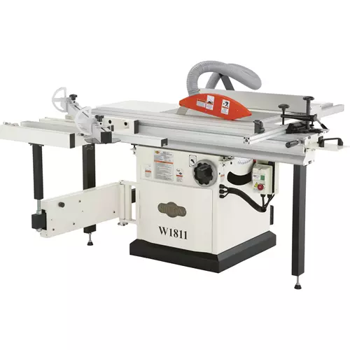

W1811 10" 5 HP Sliding Table Saw
Perfect for cutting wide panels in limited shop space.
The 10" W1811 10" 5 HP Sliding Table Saw from Shop Fox features a 78-1/2" wide crosscut capacity.
The scoring blade pre-scores the material, minimizing tear-out for a smooth, professional finish. The material then follows through the 10" main blade for a clean, precise cut.
The telescoping crosscut fence has two rock-solid flip stops. The fully-adjustable miter fence has its own flip stop.
This 10" Sliding Table Saw makes quick work of all standard plywood panels.
Additional features include the two-position extruded-aluminum rip fence and a large blade guard with integral dust port.
The W1811 manual was written by our U.S.-based Technical Documentation Department. The complete and easy-to-read manual makes it easier to assemble and maintain your saw.
The Shop Fox Customer Service and Technical Support Teams are also U.S.-based.
CSA certified
- Motor: 5 HP, 230V, single-phase, 19A
- Rip capacity: 33"
- Crosscut capacity: 78-1/2"
- Blade tilt: 0°–45°
- Maximum depth of cut @ 90°: 3-1/8"
- Maximum depth of cut @ 45°: 2-1/8"
- Main table dimensions: 40" x 47"
- Sliding table dimensions: 12-1/4" x 63"
- Main blade size: 10"
- Main blade speed: 4000 RPM
- Main blade arbor: 5/8"
- Scoring blade size: 3-1/8"
- Scoring blade speed: 8000 RPM
- Scoring blade arbor: 22mm
- Maximum dado width: 13/16"
- Floor space required: 150" W x 123" D
- Dust port sizes: 2-1/2", 4"
- Overall size: 76" W x 124-3/4" D x 46" H
- Approximate shipping weight: 688 lbs.
- Two-year warranty!!
- Shielded and lubricated bearings
- Magnetic switch with thermal overload protection
- Includes extended-reach push stick
