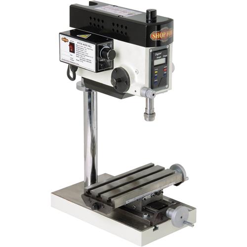

M1036 Shop Fox 4" x 8" Micro Milling Machine
A mill for model makers and others needing intricate parts.
The M1036 4" x 8" Micro Milling Machine from Shop Fox is perfect for machining high-precision small parts.
The digital depth readout provides accurate height measurements, zeroing at any height, and incremental readout adjustments.
The variable-speed dial controls the spindle speed. The high/low speed range is dependent on which pulley the belt is on.
The 3-1/2" x 8" table can be moved in two axes. Each axis is independently controlled by a crank handle. Each handle has graduated dials for precise movement.
The M1036 has a traditional downfeed lever for quill movement. It also has a micro downfeed knob for more accurate control of quill depth.
Like all Shop Fox mills, the M1036 comes with a 2-year limited warranty.
The M1036 manual was written by our U.S.-based Technical Documentation Department and is packed with useful information. The complete and easy-to-read manual makes it easier to assemble and maintain your mill.
The Shop Fox Customer Service and Technical Support Teams are also U.S.-based. Parts for the mill may be available online and shipped from the parts warehouse in Springfield, MO.
Made in an ISO 9001 Factory

Pictured with the optional M1038 Quick Vise and M1037 Collet which are not included.
