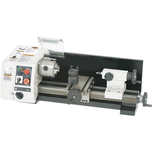

Shop Fox M1015 - 6" x 10" Mini Metal Lathe
No Reviews
$1,125.00
  • Motor: 1/5 HP
  • Swing: 6 in.
  • Distance between centers: 10 in.
  • Spindle bore: 0.375 in.
  • Spindle type: Intrinsic Back Plate
  • Speeds: 100–2000 RPM
  • Tailstock taper: MT#1
  • Tailstock barrel travel: 2 in.
  • Shipping weight: 78 lbs.
M1015 Shop Fox 6" x 10" Mini Metal Lathe
A lathe for the mini machine shop enthusiast.
The M1015 6" x 10" Mini Metal Lathe from Shop Fox is the perfect lathe for someone who wants a durable and well-designed machine that can fit in a small location.
This mini lathe gives toolmakers and weekend machinists a way to economically produce small precision parts, threaded parts, fittings, and dies.
The M1015 has all the features and precision required for small-scale turning and has proven to be a hugely popular machine for scale model building.
It includes a 3" three-jaw chuck, and a full selection of optional accessories is also available for a wide variety of setups.
The M1015 manual was written by our U.S.-based Documentation Department is packed with useful information.
The Woodstock Technical Support team is U.S. based. Parts for the lathe may be available online and shipped from the Woodstock parts warehouse in Springfield, MO.
  • Motor: 1/5 HP, 110V, single-phase, 1.2A
  • Swing over bed: 6"
  • Distance between centers: 10"
  • Spindle speed: Variable, 100–2000 RPM
  • Spindle bore: 0.375"
  • Spindle taper: MT#2
  • Tailstock quill travel: 2"
  • Swing over cross slide: 4-1/8"
  • Swing over saddle: 5"
  • Cross slide travel: 2-3/8"
  • Carriage travel: 10"
  • Bed width: 3-1/4"
  • Leadscrew: 16 TPI
  • Inch thread range: 5, 12–24 TPI
  • Max. tool size: 3/8"
  • Overall size: 27-3/4" W x 11-1/2" D x 12" H
  • Approximate shipping weight: 78 lbs.
  • Two-year warranty!!
