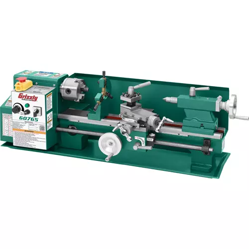

Image for Grizzly G0765 - 7" x 14" Variable-Speed Benchtop Metal Lathe

G0765 7" x 14" Variable-Speed Benchtop Metal Lathe
A small bench lathe with impressive torque for small parts production.
First and foremost, it features a special "Big Boy" tailstock which was designed with the same convenient quick-locking controls and extra-long footprint previously only found on our much larger lathes.
It also features variable-speed spindle controls with digital RPM display for dialing in the perfect cutting speed, a two-speed gearbox for the extra torque needed when turning at lower speeds and the ability to cut a wide range of inch and metric threads.
This lathe includes all the essential standard equipment you'll need to get up and running including: a 3-jaw chuck with internal and external jaws, 5" faceplate, steady rest, 4-way turret tool post and MT#2 and MT#3 dead centers.
Like all of the Grizzly lathes, the G0765 comes with a 1-year warranty covering parts and assuring the unit is free from factory defects.
The G0765 manual was written by our U.S.-based Documentation Department is packed with useful information.
The Grizzly Technical Support team are also U.S.-based. Parts for the lathe may be available online and shipped from the Grizzly parts warehouse in Springfield, MO.
