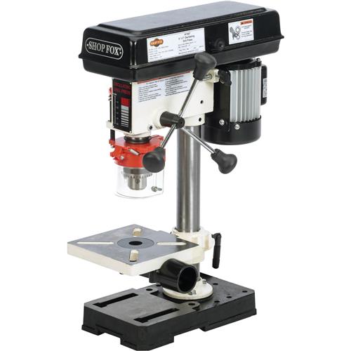

W1667 8-1/2" Benchtop Oscillating Drill Press
A benchtop drill press with the ability for oscillating contour sanding.
The Shop Fox W1667 8-1/2" Oscillating Drill Press is both a drill press and an oscillating sander in one compact machine.
The W1667 is fitted with a JT33 keyed drill chuck, offers up to 2" of travel and a drilling capacity of 1/2" through mild steel.
The 1/2 HP motor smoothly powers the five spindle speeds ranging from 550 to 3000 RPM.
A sanding spindle is included for use with drums ranging in size from 1" to 2" in diameter and is 4-1/4" long.
Purchasing additional drums and sleeves will allow you to sand small or finely detailed pieces.
With the oscillating feature, your abrasives will last longer and provide a better finish.
The 7" by 7" table allows surfaces to be sanded at many different angles as it tilts 90° in both directions.
Included are table inserts to give maximum support for the workpiece and a dust port for connection to your dust collection system.
Within a small footprint, this is drill press packs a ton of functionality, yet won't take up space.
The W1667 manual was written by our U.S.-based Technical Documentation Department and is packed with useful information. The complete and easy-to-read manual makes it easier to assemble and maintain your drill press.
Made in an ISO 9001 Factory
  • Motor: 1/2 HP, 110V, single-phase, 5A
  • Swing: 8-1/2"
  • Drill chuck: 1/16"–1/2"
  • Drilling capacity: 1/2" mild steel
  • Spindle taper: JT-33
  • Spindle travel: 2"
  • Oscillating stroke length: 1/2"
  • Number of speeds: 5, 620–3100 RPM
  • Column diameter: 1-3/16"
  • Table size: 7" x 7"
  • Table swing: 360°
  • Table tilts: 90° L/R
  • Table T-slots: 4 @5/8"
  • Footprint: 12-1/4" x 7-3/4"
  • Overall size: 9" W x 17" D x 23" H
  • Approximate shipping weight: 51 lbs.
  • Two-year warranty!!
  • 1/2" Oscillating spindle
  • 2" Table dust collection fitting
  • Sanding drum shaft
  • 1/2 HP motor
  • 5 Speeds
  • Cushioned grip quill handles
  • 1/64"–1/2" Chuck
