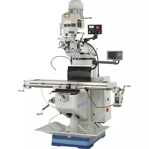

SB1027F 9" x 48" EVS 3 HP Turret Mill with DRO
A fully-loaded South Bend knee mill.
The South Bend 9" x 48" 3 HP Turret Mill features 3-axis table movement with built-in longitudinal power feed.
Electronic variable speed (EVS) allows for on-the-fly speed adjustments–no need for belt changes.
The head is mounted on a wide-dovetail movable ram with 13" of travel on the column and 360° rotating capability. The head itself can swivel 90° left/right or 45° forward/back for positioning in nearly any setup.
A Fagor 3-axis digital readout (DRO) reads down to a 0.0002" resolution for repeatable, accurate milling operations.
Quality Allen-Bradley® electrical components and attention to detail provide dependable electrical control of the powered movements.
The saddle and knee ways are hand-scraped and have been coated with Turcite®-B Slydway® for smooth, ultra-precise movement.
And finally, this milling machine comes with a circulating coolant system with the pump and reservoir in the column base.
The complete and easy-to-read SB1027F manual provides full instructions on how to assemble and maintain your mill.
