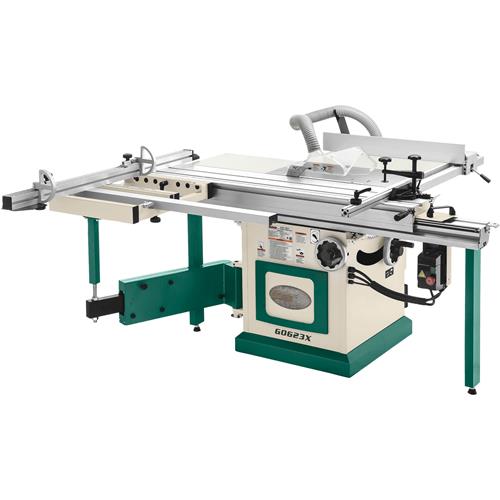

Grizzly G0623X - 10" 5 HP Sliding Table Saw
4.4 (44)
$5,275.00
  • Motor: 5 HP
  • Tablesaw type: Sliding
  • Blade size: 10 in.
  • Maximum cutting height @ 90deg: 3-1/8 in.
  • Maximum cutting height @ 45deg: 2-1/4 in.
  • Maximum ripping capacity - right: 33 in.
  • Table type: Precision-Ground Cast Iron
  • Overall table size: 47 in. x 40 in.
  • Shipping weight: 688 lbs.
G0623X 10" 5 HP Sliding Table Saw
A sliding table saw for those with limited shop space.
The G0623X 10" Sliding Table Saw perfectly blends traditional table saw functionality with easy-to-use sliding table ripping and saw cross-cutting capability.
The G0623X allows full-sheet cutting capacity for crosscuts and miters, plus the added benefit of 33" of ripping capacity.
The scoring blade pre-scores the material, minimizing tear-out for a smooth, professional finish. The material then follows through the 10" main blade for a clean, precise cut.
The dust shroud has a 2-1/2" dust port that connects directly to the riving knife mount to keep the cutting area clean during operation.
The compact but heavy-duty aluminum 12-1/4" x 63" sliding table travels on ball-bearing guides for an effortless cutting action.
The 2" tall crosscut fence extends up to 78-3/4" to evenly support your workpiece and allows for cross cutting pieces up to 63" wide.
For miter cuts, simply rotate the fence assembly and lock it in place for miters up to 48" wide when set at 45°.

  • Motor: 5 HP, 230V, single-phase,19A
  • Rip capacity: 33"
  • Crosscut capacity: 78-1/2"
  • Blade tilt: 0–45°
  • Max. depth of cut @ 90°: 3-1/8"
  • Max. depth of cut @ 45°: 2-1/4"
  • Main table size: 27" x 14-3/8"
  • Sliding table size: 63" x 12-1/4"
  • Floor-to-table height: 33-5/8"
  • Main blade size: 10"
  • Main blade arbor: 5/8"
  • Main blade speed: 4000 RPM
  • Scoring blade size: 3-1/8" (80mm)
  • Scoring blade arbor: 22mm
  • Scoring blade speed: 8000 RPM
  • Max. width of dado: 13/16"
  • Dust port sizes: 2-1/2", 4"
  • Footprint: 25-1/2" L x 28" W
  • Floor space required: 150" W x 123" D
  • Overall dimensions: 76" W x 125" D x 46" H
  • Approximate shipping weight: 688 lbs.
  • Scoring blade ensures tear-out free cuts
  • A quick clamp-on, extruded aluminum sliding table
  • Miter fence positions 45° right or left with two flip stops for repetitive cutting
  • Auxiliary 2-1/2" dust port at the blade for maximum dust collection
  • Precision-ground cast-iron main table with extensions
  • Single-lever locking fence
