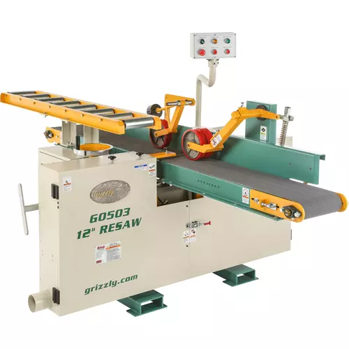

G0503 12" 20 HP Horizontal Resaw Bandsaw
An industrial resaw for increased production.
With a massive 20 HP motor, 28" diameter wheels and 168" blade, the G0503 12" 20 HP Horizontal Resaw Bandsaw can resaw all day long from the hardest species of wood without taking a rest.
You can count on accurate and consistent results every time because of the horizontal design.
This bandsaw was designed with careful detail for maximizing production to maximize safety and production, so you can keep your profits riding high.
