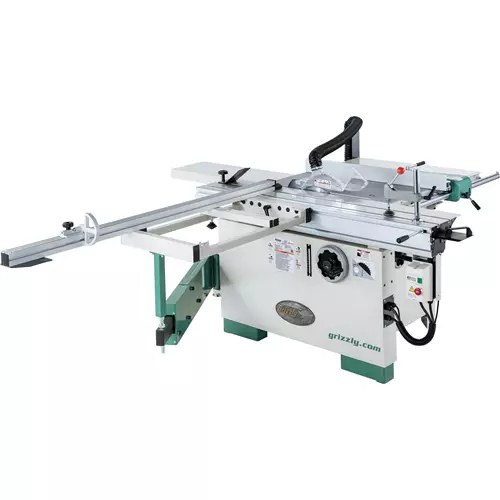

G0820 12" 7-1/2 HP 3-Phase Compact Sliding Table Saw
A compact and high horsepower sliding table saw.
A sliding table saw can also take up a lot of room. What to do if you're pressed for shop space?
The space-saving G0820 12" 7-1/2 HP 3-Phase Compact Sliding Table Saw, measures 118" x 90"!
This slider will allow you to crosscut sheets up to 63" x 101-1/2" and rip panels as wide as 33".
The scoring blade pre-scores the material, minimizing tear-out for a smooth, professional finish. The material then follows through the 12" main blade for a clean, precise cut.
Don't let the smaller size fool you; this 7-1/2 HP workhorse has all of the user-friendly features you'd expect from an industrial-duty sliding table saw.
These features include a miter fence with adjustable flip-stops, dust ports above and below the blade, riving knife, a standard rip fence and a clamping hold-down system for the sliding table.
For production ripping and crosscutting, every shop needs a sliding table saw—and the G0820 just might be the perfect fit!
The G0820 manual was written by our U.S.-based Technical Documentation Department and is packed with useful information; making it easier to assemble and maintain your saw.
*This machine is prewired for 220V. We can rewire to 440V in a few days’ time for a fee. Please contact Grizzly Technical Support at (570) 546-9663 before placing your order.
  • Motor: 7-1/2 HP, 220V/440V* (prewired for 220V), 3-phase, 20A/10A
  • Minimum circuit size: 30A @ 220V, 15A @ 440V
  • Rip capacity: 33"
  • Crosscut capacity: 63"
  • Blade tilt: 0–45°
  • Max. depth of cut @ 90°: 3-5/16"
  • Max. depth of cut @ 45°: 2-3/8"
  • Main table size: 40" x 68"
  • Sliding table size: 63" x 12-1/4"
  • Floor-to-table height: 34-1/4"
  • Main blade size: 12"
  • Main blade arbor: 1"
  • Main blade speed: 4000 RPM
  • Scoring blade size: 4-3/4" (120mm)
  • Scoring blade arbor: 20mm
  • Scoring blade speed: 8000 RPM
  • Dust ports: 2
  • Dust port size: 2-1/2" (compatible with standard shop vacuums), 5"
  • Footprint: 35" x 45"
  • Overall dimensions: 118" W x 90" D x 45" H
  • Approximate shipping weight: 996 lbs.
  • Crosscut fence for 90° and 45° cuts
  • Aluminum rip fence
  • Double roller-carriage sliding table
  • Adjustable riving knife
  • Adjustable blade hood guard
  • 5" Main dust port
  • Blade tilts 45° for miter cutting
  • Precision-ground cast-iron main table
  • 1-year limited warranty
