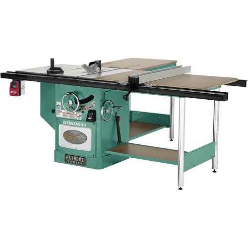

G0606X1 12" 7-1/2 HP 3-Phase Extreme Table Saw
Enjoy all the innovation this large-capacity saw has to offer!
The G0606X1 12" 7-1/2 HP 3-Phase Extreme Table Saw with side and outfeed table extensions is designed to handle the largest of panels, providing ample workpiece support before, during, and after the cut.
Features include a digital readout for bevel angle, a user-friendly blade guard, a riving knife, and storage shelves.
An efficient dust management system that includes an internal dust port. A sloped cabinet floor that directs saw dust into the 4" dust port. This greatly improves the efficiency of collecting the dust particles and helps your dust collector.
The G0606X1 manual was written by our U.S.-based Technical Documentation Department and is packed with useful information. The complete and easy-to-read manual makes it easier to assemble and maintain your saw.
Made in an ISO 9001 Factory
CSA certified
*This machine is prewired for 220V. We can rewire to 440V in a few days’ time for a fee. Please contact Grizzly Technical Support at (570) 546-9663 before placing your order.
SPECIFICATIONS
  • Motor: 7-1/2 HP, 220V/440V* (prewired for 220V), 3-phase, 19.5A/10A
  • Minimum circuit size: 30A @ 220V, 15A @ 440V
  • Rip capacity: 52" right, 18" left of blade
  • Max. depth of cut @ 90°: 4"
  • Max. depth of cut @ 45°: 2-3/4"
  • Overall table dimensions: 69-1/2" x 78-3/4"
  • Distance from front of table to center of blade: 17-1/4"
  • Floor-to-table height: 35-3/4"
  • Arbor diameter: 1"
  • Arbor speed: 3600 RPM
  • Max. width of dado: 3/4"
  • Dust port size: 4"
  • Footprint: 22-1/2" x 24"
  • Space required: 91-1/2" x 79-1/2"
  • Overall dimensions: 91-1/2" W x 93" D x 42-1/2" H
  • Approximate shipping weight: 895 lbs.
FEATURES
  • Digital readout for bevel angle
  • Right and rear extension tables
  • Cast-iron trunnions
  • 3/8" x 3/4" T-slots and miter gauge
  • Smooth and quiet poly-V serpentine belt drive system
  • Steel cabinet
  • Hinged motor cover
  • Magnetic switch with thermal overload protection and lock-out padlock
  • Quick-change between riving knife and splitter guard
  • 1-year limited warranty
