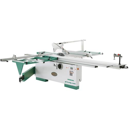

Grizzly G0699 - 12" 7-1/2 HP 3-Phase Sliding Table Saw with Scoring
4.7 (3)
$8,995.00
G0699 12" 7-1/2 HP Sliding Table Saw with Scoring
The largest cutting capacity of any Grizzly 12" sliding table saw.
Ramp up production with the three-phase G0699 12" 7-1/2 HP Sliding Table Saw that can both crosscut and rip up to 126".
The scoring blade pre-scores the material, minimizing tear-out for a smooth, professional finish. The material then follows through the 12" main blade for a clean, precise cut.
This saw features a riving knife that moves up and down with the blade, a micro-adjustable rip fence for traditional table saw cuts, and an extruded-aluminum, extendable crosscutting fence with two flip stops.
Best of all, this saw has the capabilities and options typically only found on much more expensive machines.
Whether you run 220V or 440V, this saw will have you ripping down sheet goods with the precision and reliability your business requires.
The G0699 manual was written by our U.S.-based Technical Documentation Department and is packed with useful information. The complete and easy-to-read manual makes it easier to assemble and maintain your saw.
*This machine is prewired for 220V. We can rewire to 440V in a few days’ time for a fee. Please contact Grizzly Technical Support at (570) 546-9663 before placing your order.
  • Main motor: 7-1/2 HP, 220V/440V* (prewired for 220V), 3-phase, 20A/10A
  • Scoring motor: 1 HP, 3-phase, 3.2A/1.6A
  • Minimum circuit size: 30A @ 220V, 15A @ 440V
  • Rip capacity: 49-3/4"
  • Crosscut capacity: 126"
  • Blade tilt: 0–45°
  • Max. depth of cut @ 90°: 3-5/16"
  • Max. depth of cut @ 45°: 2-3/8"
  • Main table size: 59" x 68"
  • Sliding table size: 126" x 14"
  • Floor-to-table height: 36"
  • Main blade size: 12"
  • Main blade arbor: 1"
  • Main blade speed: 4000 RPM
  • Scoring blade size: 4-3/4"
  • Scoring blade arbor: 20mm
  • Scoring blade speed: 8000 RPM
  • Number of dust ports: 2
  • Dust port size: 4", 5"
  • Footprint: 74-1/2" x 35-1/2"
  • Overall dimensions: 139" W x 133" D x 45" H
  • Approx. shipping weight: 1498 lbs.
  • Micro-adjustable rip fence
  • Scoring saw blade ensures tear-out free cutting
  • Blade tilts 45° for miter cutting
  • 5" Main dust port, 4" upper dust port
  • Aluminum alloy crosscut fence for miter cutting 45° right and left
  • Miter fence has two flip-stops for repetitive cutting
  • Safety limit switch for blade cover
  • Cast-iron trunnions
  • 1-year limited warranty
