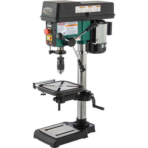

T31739 12" Variable-Speed Benchtop Drill Press with Laser
A benchtop drill press with all the versatility of a large floor model.
The Grizzly T31739 12" Variable-Speed Benchtop Drill Press with Laser has all the features of a floor drill press, but in a compact package that fits anywhere. Not compromising on the hefty construction, this cast-iron drill press with steel column weighs in at 88 lbs.
The 1/3 HP motor smoothly powers the variable speed from 400–2700 RPM which can be monitored on the digital readout right on the headstock. The headstock also comes equipped with a laser site for accurate drill alignment and a LED work light to light up your workpiece.
The industrial-grade 1/32" - 5/8" keyless, JT3 drill chuck has a large-diameter knurled body to provide plenty of hand torque for tightening. With 3-1/2" of spindle travel and a drill capacity of 5/8" through cast iron or mild steel, be confident it can easily drill through hardwoods, fiberglass, plastic and composites.
The precision-ground cast-iron table is 9-5/8" square and tilts 45° left and right. The table includes a 7-1/4" extension for use with larger workpieces. It also has four 1/2" T-slots to help you secure a workpiece to the table with optional accessories such as a vise or hold down clamps.
