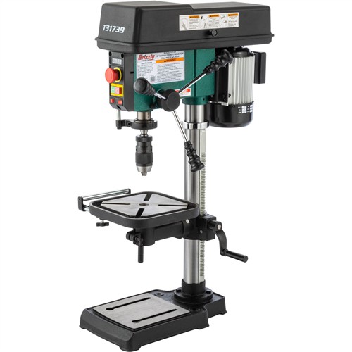

Grizzly T31739 - 12" Variable-Speed Benchtop Drill Press with Laser
4.3 (63)
$520.00
  • Motor: 1/3 HP
  • Power Requirement: 120V, Single-Phase, 60 Hz
  • Swing: 12 in.
  • Type: Bench
  • Range of Spindle Speeds: 400–2700 RPM
  • Drilling Capacity: 5/8 in.
  • Drill Chuck Type: JT3 Keyless Chuck
  • Quill Diameter: 1.575 in.
  • Shipping weight: 93 lbs.
T31739 12" Variable-Speed Benchtop Drill Press with Laser
A benchtop drill press with all the versatility of a large floor model.
The Grizzly T31739 12" Variable-Speed Benchtop Drill Press with Laser has all the features of a floor drill press, but in a compact package that fits anywhere. Not compromising on the hefty construction, this cast-iron drill press with steel column weighs in at 88 lbs.
The 1/3 HP motor smoothly powers the variable speed from 400–2700 RPM which can be monitored on the digital readout right on the headstock. The headstock also comes equipped with a laser site for accurate drill alignment and a LED work light to light up your workpiece.
The industrial-grade 1/32" - 5/8" keyless, JT3 drill chuck has a large-diameter knurled body to provide plenty of hand torque for tightening. With 3-1/2" of spindle travel and a drill capacity of 5/8" through cast iron or mild steel, be confident it can easily drill through hardwoods, fiberglass, plastic and composites.
The precision-ground cast-iron table is 9-5/8" square and tilts 45° left and right. The table includes a 7-1/4" extension for use with larger workpieces. It also has four 1/2" T-slots to help you secure a workpiece to the table with optional accessories such as a vise or hold down clamps.
The manual for the T31739 Drill Press was written by our U.S.-based Documentation Department and is packed with useful information.
  • Motor: 1/3 HP, 120V, single-phase, 5.1A
  • Swing: 12"
  • Spindle taper: MT#2
  • Spindle travel: 3-1/2"
  • Spindle speeds: Variable, 400–2700 RPM
  • Drill chuck: 1/32"–5/8", JT3, keyless
  • Drilling capacity: 5/8" mild steel
  • Max. distance from spindle to table: 13-1/4"
  • Table dimensions: 9-5/8" x 9-5/8"
  • Table tilt: 45° left/right
  • Table swivel around column: 360°
  • Table T-slots: (x4) 1/2", X pattern
  • Footprint: 16" x 9-1/2"
  • Overall dimensions: 13" W x 22" D x 36" H
  • Approximate shipping weight: 93 lbs.
  • Adjustable laser sight
  • Precision-ground cast-iron table with 7-1/4" extension
  • LED work light
  • Digital readout for spindle speed
  • 0–90mm depth stop with quick-release
  • Rack-and-pinion table elevation control
  • 1-year limited warranty
