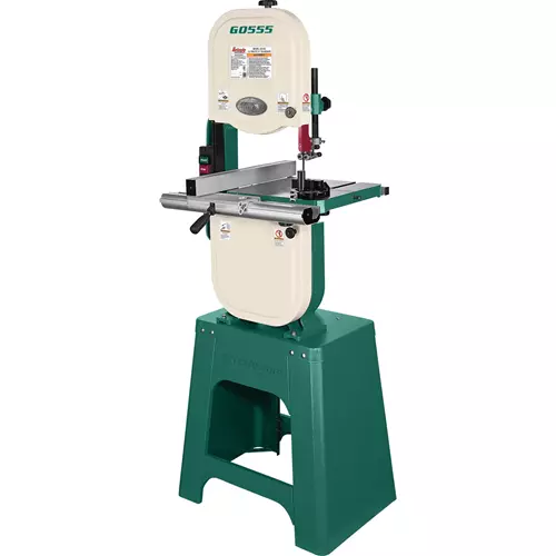

Grizzly G0555 - 14" 1 HP Bandsaw
4.9 (150)
141
$836.00
List Price: $950.00
You Save: $114.00 (12%)
Buy now! Sale Ends 1/1/26
  • Motor: 1 HP
  • Max cutting width: 13-1/2 in.
  • Max cutting height: 6 in.
  • Table size: 14 in. x 14 in.
  • Wheel type: Computer-Balanced Cast-Aluminum
  • Blade size: 93-1/2 in.
  • Quick blade change: Yes
  • Overall height: 66-1/2 in.
  • Shipping weight: 207 lbs.
G0555 The Classic 14" Wood Bandsaw
An award-winning bandsaw for home and small shops.
The G0555 Classic 14" Bandsaw was awarded the Best Industrial-Grade Band Saw by Tool Digest and Best Value by WOOD Magazine.
Backed by a 1 HP motor and a capacity of 14", it has the power and room to resaw and crosscut hardwoods while also accurately cutting curves, circles, and decorative scrolls with ease.
The cast-iron table is machined to a smooth ground top finish. It tilts up to 45° to the right and up to 15° to the left.
The deluxe extruded aluminum fence is designed for easy attachment and removal from the rails. It has a magnified cursor scale for fast and accurate adjustments.
Blade guides adjustments are made quickly with the eccentric bearing mounts, making changing blades simple and always cutting at optimal performance.
The H3051 Riser Block Kit is available to increase the capacity of this bandsaw from 6" to 12".
No tools are required to access the wheels or the blade. With one swing of a lever, the quick release blade tensioner drops the upper wheel allowing easy blade replacement. For a full range replacement and resaw blades for the G0555, shop here.
Prewired for 110V, the G0555 can plug into a standard 110V wall receptacle. This machine can be converted to operate on a 220V power supply by referring to the voltage conversion instructions in the manual.
The easy-to-read G0555 manual was written by our U.S.-based Technical Documentation Department and is packed with useful information.
CSA certified
  • Motor: 1 HP, 110V/220V (prewired 110V), single-phase, 11A/5.5A
  • Throat (max. width left of blade): 13-1/2"
  • Resaw capacity: 6"
  • Table size: 14" x 14"
  • Table tilt: 15° left, 45° right
  • Floor-to-table height: 43-5/16"
  • Blade size: 93-1/2" (1/8"–3/4" wide)
  • Blade speed: 1500, 3200 FPM
  • Footprint: 24-1/2" x 17-1/2"
  • Overall dimensions: 26-1/2" W x 30-1/2" D x 66-1/2" H
  • Approximate shipping weight: 207 lbs.
  • Deluxe extruded aluminum rip fence
  • Heavy-duty steel stand
  • Cast-iron frame
  • Quick-release blade tension
  • Computer-balanced cast-aluminum wheels with rubber tires
  • Includes a miter gauge and 3/8" blade
  • 1-year limited warranty
