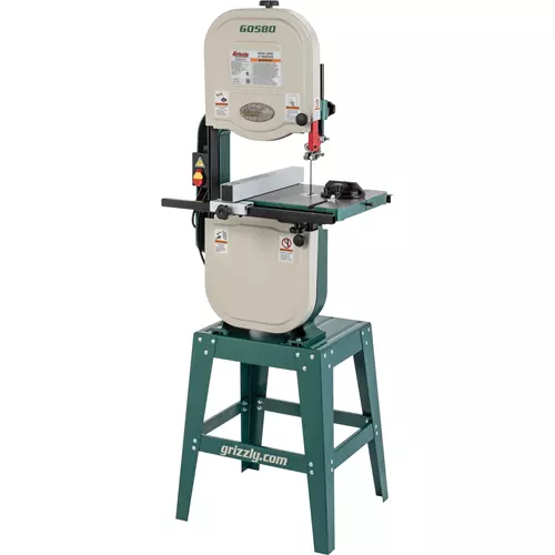

G0580 14" 3/4 HP Bandsaw
Robust performance and quality construction in a lightweight, affordable design.
The G0580 14" Bandsaw offers a blend of durability, portability, and performance, making it a reliable tool for any woodworker. Its sturdy construction and user-friendly features ensure accurate and efficient cutting for a wide range of projects.
FEATURES and BENEFITS:
- Durable Cast-Iron Construction: The solid cast-iron frame and precision-ground table provide stability and accuracy, ensuring consistent performance over time.
- Lightweight Versatility: The open-frame steel stand balances durability with portability, allowing for easy movement around the shop or transportation to jobsites.
- Precision Cutting: Achieve accurate cuts with the included extruded-aluminum fence and miter gauge. The upper and lower guide blocks and thrust bearings enhance blade stability and control.
- Enhanced Dust Collection: The 4" dust port allows for efficient dust removal, maintaining a cleaner and safer work environment.
- Ample Cutting Capacity: With a 13-1/2" throat and 6-1/4" maximum cutting height (expandable to 12" with an optional H7316 riser block), the G0580 handles various project sizes.
- Balanced Blade Wheels: Computer-balanced cast aluminum wheels with rubber tires reduce vibration for smoother operation.
Prewired for 115V, the G0580 can plug into a standard 115V wall receptacle with the included 5-15 plug or can be converted to operate on a 230V power supply. If you prefer 230V, refer to the voltage conversion instructions in the manual. You will need to provide your own 6-15 plug.
This bandsaw comes with a 3/8" 6 TPI hook blade. For a full range replacement blades for the G0580, shop here.
