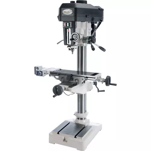

G0810 16" Drill Press with Cross-Slide Table and Power Feed
An industrial drill press with precision controls for producing heavy-duty work.
The G0810 16" Drill Press features a power feed for X-axis movement and a cross slide table to help you produce high-precision work.
With 14-7/8" of X-axis travel and 7" of Y-axis travel, the G0810 provides easy adjustability with both the X and Y-axis.
The twelve spindle speeds range from 150–3000 RPM based on v-belt positioning. The low RPM speed is vital to drilling metal.
Set the depth stop and use the coarse downfeed for fast production drilling, or switch over to the fine-downfeed handwheel for precision control up or down along the generous 5-1/8" spindle travel.
A good drill press starts from the ground up, and this one offers the foundation you need with a thick, heavy-cast 26" x 19" base and beefed up 4-1/2" column for rigidity and stability that you can count on.
  • Motor: 1-1/2 HP, 220V, single-phase, 11.5A
  • Swing: 16"
  • Spindle taper: MT#3
  • Spindle travel: 5-1/8"
  • Number of spindle speeds: 12
  • Spindle speed range: 150–3000 RPM
  • Max distance spindle-to-table: 19-7/8"
  • Table size: 23-1/16" L x 7-1/2" W x 1-3/4" H
  • Vertical table travel: 20"
  • Table swivel (left/right): 360°
  • Quill diameter: 2.95"
  • Drawbar thread size: M12"-1.75
  • Drilling capacity mild steel: 1-1/4"
  • End milling capacity: 3/4"
  • Face milling capacity: 3"
  • T-slot width: 1/2" (4 on table, 2 on base)
  • Footprint: 26" L x 19" W
  • Overall dimensions: 42" W x 39-1/2"D x 65" H
  • Approximate shipping weight: 685 lb.
  • MT#3 spindle taper
  • 5-1/8" of spindle travel
  • 12 spindle speeds between 150–3000 RPM
  • Longitudinal power feed on X/Y-axis table with independent power supply
  • 360° table rotation around column
  • Fine-downfeed handwheel adjustment
  • Four 1/2" T-slots in the table, plus two more in the base
