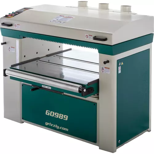

G0989 40" Planer with V-Helical Cutterhead
The ultimate wide planing solution for professionals.
Elevate your production capabilities with a 40" planer. Engineered for industrial-grade performance, this machine effortlessly handles wide, unwieldy slabs, maximizing your output and minimizing downtime. Essential for complex projects including live-edge tabletops, large edge-glued panels, countertops, and more.
A 6-row V-helical cutterhead with 249 indexable carbide inserts delivers a 40" capacity, reducing noise, minimizing tearout, improving finishes, and efficiently directing chips for dust collection.
This unique machine offers an extensive list of features designed to maximize productivity and efficiency.
  • 20 HP motor for unstoppable power
  • Digitally controlled table elevation with 5 presets for repeat production
  • Hinged headstock cover for easy access to cutterhead
  • Built-in steel infeed support roller for easy board feeding
  • Chain-driven feed rollers ensure reliable and consistent feed rate
  • Smooth polyurethane-coated steel outfeed roller prevent material slippage
  • Anti-kickback fingers significantly reduce the risk of kickback incidents
  • Secondary, rear-mounted e-stop button for added safety
  • Heavy-duty steel construction throughout
  • Three 5" dust ports optimize dust extraction
Keep your live-edge table production, custom furniture manufacturing, and high-end cabinetry projects on time and on budget with this heavy-duty planer! Experience the G0989 Planer for yourself and discover why it's a top choice for extra-wide stock planing.
  • Required power source: 220V or 440V, 3-phase, min. 75A circuit at 220V, 30A at 440V
  • Main motor: 20 HP, 220V/440V* (prewired for 220V)
  • Feed motor: 2 HP
  • Elevation motor: 1/2 HP
  • Max. stock width: 40"
  • Max. stock thickness: 11-3/4"
  • Min. stock thickness: 1/4"
  • Min. stock length: 16-1/2"
  • Max. cutting depth full width: 1/8"
  • Max. cutting depth 6": 1/4"
  • Cutterhead diameter: 5"
  • Cutterhead type: 6-Row helical, 249 inserts
  • Cutterhead speed: 5200 RPM
  • Insert size & type: 15 x 15 x 2.5mm, indexable carbide
  • Feed rate: Variable, 16–59 FPM
  • Table size: 40" x 43-5/16"
  • Dust port: 3, 5"
  • Footprint: 29" x 59-1/2"
  • Overall dimensions: 61" W x 47" D x 51" H
  • Approximate shipping weight: 3382 lbs.
