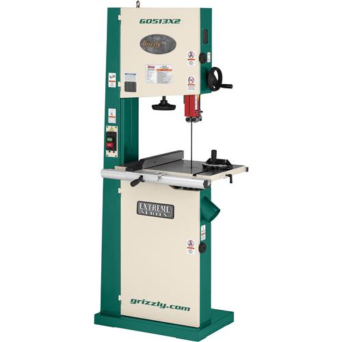

Grizzly G0513X2 - 17" 2 HP Bandsaw w/ Cast-Iron Trunnion
4.9 (194)
181
$2,250.00
  • Motor: 2 HP
  • Max cutting width: 16-1/4 in.
  • Max cutting height: 12 in.
  • Table size: 17-1/4 in. x 23-5/8 in.
  • Wheel type: Computer-Balanced Cast Iron
  • Blade size: 131-1/2 in.
  • Quick blade change: Yes
  • Overall height: 73 in.
  • Shipping weight: 421 lbs.
G0513X2 17" 2 HP Wood Bandsaw
From top to bottom, this woodcutting bandsaw is built to perform.
The G0513X2 17" 2 HP Bandsaw features a heavy-duty cast-iron trunnion and double ball-bearing blade guides usually only found on machines costing much, much more.
The 2 HP motor powers through hardwoods with a 12-1/8" cutting height and 16-1/4" throat provide ample cutting capacity for most applications. For a full range replacement and resaw blades for your G0513X2, click here.
The G0513X2 has a large 23-5/8" x 17-1/4" cast-iron table that can tilt from 5° left to 45° right. A cast-iron fence with extruded-aluminum rail and resaw fence attachment mount to the table.
Power and capacity are just a part of why owners continue to give this bandsaw a solid 5-star rating.
The stout steel frame houses the heavy computer-balanced cast-iron wheels designed to minimize vibration during resaw operations.
This machine is prewired to operate on a 220V power supply circuit that has a verified ground and meets the 220V operation requirements. If you prefer 110V, refer to the Voltage Conversion instructions in the manual.
The G0513X2 manual was written by our U.S.-based Technical Documentation Department and is packed with useful information. The complete and easy-to-read manual provides full instructions on how to assemble and maintain your bandsaw.
CSA certified
  • Motor: 2 HP, 110V/220V (prewired 220V), single-phase, 19A/9.5A
  • Throat (max. width left of blade): 16-1/4"
  • Resaw capacity: 12"
  • Blade size: 131-1/2" long
  • Blade width range: 1/8"–1" wide
  • Blade speeds: 1700, 3500 FPM
  • Table size: 23-5/8" x 17-1/4"
  • Table tilt: 5° left, 45° right
  • Floor to table height: 37-1/2"
  • Footprint: 27" W x 18" D
  • Overall size: 32" W x 32" D x 73" H
  • Approximate shipping weight: 421 lbs.
  • Deluxe cast-iron fence with extruded aluminum resaw fence attachment
  • Magnifying window over fence scale
  • Quick-change blade release/tensioner
  • Blade tension indicator
  • Micro-adjusting geared table
  • Blade height scale measurement
  • Blade tracking window
  • Cast-iron table trunnions
  • Fully-enclosed ball-bearing blade guides
  • Miter gauge
  • Includes 1/2" 6-TPI hook blade
  • 1-year limited warranty
Note: The G0513X2 does not come with a plug. The recommended plug type is L5-30 for 110V or 6-15 for 220V.
