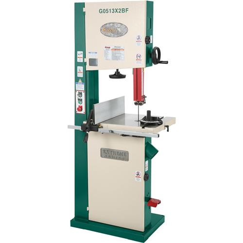

G0513X2BF 17" 2 HP Extreme Series Wood Bandsaw
Awarded Top Value by WOOD Magazine.
The awarding-winning Grizzly G0513X2BF 17" 2 HP Bandsaw with a cast-iron trunnion was recognized because of its combination of features including both an automatic brake that stops the blade in less than two seconds at shutdown and a foot brake for emergencies.
The 2 HP motor powers through wood at a maximum 12" cutting capacity and the 16-1/4" throat is big enough for most applications. For a full range replacement and resaw blades for the G0513X2BF, shop here.
The G0513X2BF has an extra-wide 23-5/8" x 17-1/4" cast-iron table that can tilt from 5° left to 45° right. The cast-iron fence includes a 6" tall extruded-aluminum resaw fence that attaches quickly and supports tall stock exceptionally well. The cast-iron table trunnions add additional weight for greater stability.
The magnetic power switch prevents accidental restarts after an emergency stop or loss of power and the keyed lockout adds another level of safety.
Additional features include a heavy-duty miter gauge, dual 4" dust ports to suck up all the sawdust, micro-adjusting geared table and double ball-bearing blade guides that are usually found on machines costing much more.
