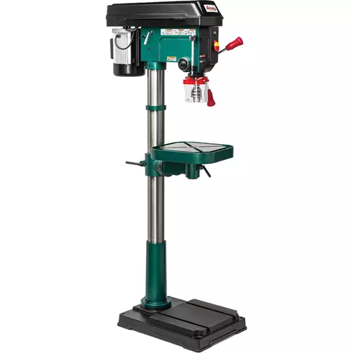

Grizzly T33903 - 17" Floor Drill Press with LED Light & Laser Guide
2.7 (3)
$859.00
MSRP: $955.00
You Save: $96.00 (10%)
Buy now! Sale Ends 1/1/26
  • Motor: 1-1/4 HP
  • Power Requirement: 120V, Single Phase, 60 Hz
  • Swing: 17 in.
  • Type: Floor
  • Range of Spindle Speeds: 210 - 3020 RPM
  • Drilling Capacity: 1 in.
  • Drill Chuck Type: JT3 Key Chuck
  • Quill Diameter: 2.043 in.
  • Shipping weight: 245 lbs.
T33903 17" 1-1/4 HP Floor Drill Press with LED and Laser
An affordable drill press with unique features and precision capabilities to maximize productivity.
This 17" floor option is a perfect choice for a beginner or an experienced hobbyist looking for a functional and economical drill press.
Whether you are countersinking, reaming, or performing other drilling steps, this press will be a valuable addition to your shop.
The 1-1/4 HP motor powers the spindle through twelve speeds from 210 to 3020 RPM and through 1" mild steel.
Use the crank handle to adjust the table vertically as needed for each project; the rack-and-pinion motion is smooth to prevent mistakes to your workpiece.
The LED light provides essential support during all drilling processes, increasing visibility to ensure accuracy every time.
With laser-line guides you can avoid costly errors during the drilling process and prevent wasted materials.
The push-button, heavy metal spindle depth stop allows for effortless adjustments and repeatable drilling.
Easily transport the drill press to other locations in your shop, or even to another site.
A durable floor drill press with the options you need to create eye-catching and functional projects.
The T33903 manual was written by our U.S.-based Technical Documentation Department and is packed with useful information.
Drill press parts may be available online and shipped from the Grizzly parts warehouse in Springfield, MO.
  • Motor: 1-1/4 HP, 120V, single-phase, 13A
  • Swing: 17"
  • Spindle taper: MT#4
  • Spindle travel: 4-3/4"
  • Spindle speeds: 12, 210–3020 RPM
  • Drill chuck: 1/8"–5/8", JT3
  • Drilling capacity: 1" mild steel
  • Maximum distance from spindle to table: 27"
  • Table dimensions: 11-1/8" x 11-1/8"
  • Table tilt: 0–45° left/right
  • Table swivel around column: 360°
  • T-slots: (x4) 5/8"
  • Footprint: 22-1/2" x 17"
  • Overall dimensions: 17" W x 31" D x 68" H
  • Approximate shipping weight: 245 lbs.
  • Built-in LED light
  • Laser line guides
  • Flip-up chuck guard
  • Push-button spindle depth stop
  • Rack-and-pinion vertical table movement
  • Heavy-duty construction
We offer U.S.-based customer service and technical support to get your questions answered and help keep your equipment running in top condition. And to ensure your satisfaction, the T33903 comes with a 1-year warranty.
