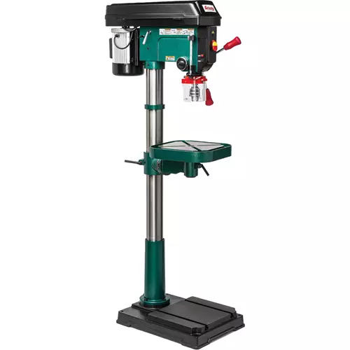

T33903 17" 1-1/4 HP Floor Drill Press with LED and Laser
An affordable drill press with unique features and precision capabilities to maximize productivity.
This 17" floor option is a perfect choice for a beginner or an experienced hobbyist looking for a functional and economical drill press.
Whether you are countersinking, reaming, or performing other drilling steps, this press will be a valuable addition to your shop.
The 1-1/4 HP motor powers the spindle through twelve speeds from 210 to 3020 RPM and through 1" mild steel.
Use the crank handle to adjust the table vertically as needed for each project; the rack-and-pinion motion is smooth to prevent mistakes to your workpiece.
The LED light provides essential support during all drilling processes, increasing visibility to ensure accuracy every time.
With laser-line guides you can avoid costly errors during the drilling process and prevent wasted materials.
The push-button, heavy metal spindle depth stop allows for effortless adjustments and repeatable drilling.
Easily transport the drill press to other locations in your shop, or even to another site.
A durable floor drill press with the options you need to create eye-catching and functional projects.
The T33903 manual was written by our U.S.-based Technical Documentation Department and is packed with useful information.
