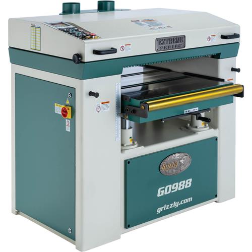

G0988 32" Planer with V-Helical Cutterhead
Wide-capacity planing, tailored for the pro.
Designed to tackle the challenges of planing wide stock up to 32", the G0988 Planer will make your life easier as a professional woodworker. With its combination of precision, power, and ease of use, this planer effortlessly handles live-edge tabletops, large edge-glued panels, countertops, and more.
A 6-row V-helical cutterhead with 201 indexable carbide inserts delivers a 32" capacity, reducing noise, minimizing tearout, improving finishes, and efficiently directing chips for dust collection.
This wide planner offers an extensive list of features designed to maximize productivity and efficiency.
  • 15 HP motor for unstoppable power
  • Digitally controlled table elevation with 5 presets for repeat production
  • Hinged headstock cover for easy access to cutterhead
  • Built-in steel infeed roller for easy board feeding
  • Chain-driven feed rollers ensure reliable and consistent feed rate
  • Smooth polyurethane-coated steel outfeed roller prevent material slippage
  • Anti-kickback fingers significantly reduce the risk of kickback incidents
  • Secondary, rear-mounted e-stop button for added safety
  • Heavy-duty steel construction throughout
  • Two 5" dust ports optimize dust extraction
Keep your live-edge table production, custom furniture manufacturing, and high-end cabinetry projects on time and on budget with this heavy-duty planer! Experience the solution for wide stock planing with the G0988 Planer.
  • Required power source: 220V or 440V, 3-phase, min. 60A circuit at 220V, 30A at 440V
  • Main motor: 15 HP, 220V/440V* (prewired for 220V)
  • Feed motor: 2 HP
  • Elevation motor: 1/2 HP
  • Maximum stock width: 32"
  • Maximum stock thickness: 11-3/4"
  • Minimum stock thickness: 1/4"
  • Minimum stock length: 16-1/2"
  • Maximum cutting depth full width: 1/8"
  • Maximum cutting depth 6": 1/4"
  • Cutterhead diameter: 5"
  • Cutterhead type: 6-Row helical, 201 inserts
  • Cutterhead speed: 5200 RPM
  • Insert size & type: 15 x 15 x 2.5mm, indexable carbide
  • Feed rate: Variable, 16–59 FPM
  • Table size: 32" x 39-3/8"
  • Dust port: 2 at 5"
  • Footprint: 26-1/2" x 37"
  • Overall dimensions: 53" W x 43" D x 51" H
  • Approximate shipping weight: 2670 lbs.
