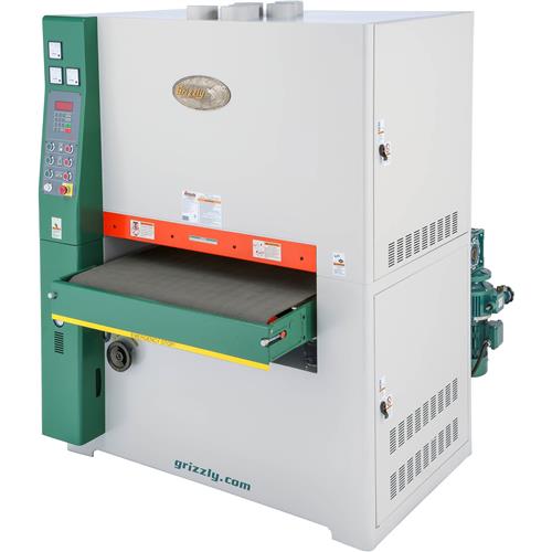

G0866 37" 15 HP Wide-Belt Sander with Industrial Roller
An industrial-grade sander ready for production work.
When your shop production schedule is on the line, trust an innovating industrial-grade wide-belt sander.
The double-head G0866 37" 15 HP Wide-Belt Sander has independent dual 15 HP sanding motors to provide the utmost in sanding power and versatility.
Oversized industrial sanding drums provide added sanding belt grip and workpiece contact area. Easily adjust the motorized table elevation with the push of a button.
An integrated digital display provides accuracy down to 0.005", and an independent 2 HP feed belt motor provides variable-speeds from 7-68 FPM to handle hardwoods and softwoods alike.
A full range of replacement belts are available.
The G0866 manual was written by our U.S.-based Technical Documentation Department and is packed with useful information. The complete and easy-to-read manual provides full instructions on how to assemble and maintain your sander.
*This machine is prewired for 220V. We can rewire to 440V in a few days’ time for a fee. Please contact Grizzly Technical Support at (570) 546-9663 before placing your order.
  • Sanding belt motors: Dual 15 HP, 220V/440V* (prewired 240V), 3-phase, 36.7/18.4A
  • Feed belt motor: 2 HP, 6.4A/3.2A
  • Table elevation motor: 1/4 HP, 1.2A/0.6A
  • Minimum circuit size: 100A @ 220V, 50A @ 440V
  • Sanding belt size: 37" x 75"
  • Maximum board dimensions: 36-1/2" W x 6" H
  • Minimum board thickness: 3/16"
  • Minimum board length: 12"
  • Conveyor speeds: Variable, 7–68 FPM
  • Front sanding belt speed: 3600 FPM
  • Rear sanding belt speed: 2800 FPM
  • Air requirement: 57–70 PSI, 7 CFM
  • Infeed drums: Spiral-grooved rubber, 8.7" and 5" dia.
  • Outfeed drum: Steel, 5" dia.
  • Overall dimensions: 59" W x 65" D x 75" H
  • Approximate shipping weight: 3968 lbs.
  • Digital height readout and control panel
  • Independent motor control
  • Disc brake for emergency stop
  • Micro-adjustable graphite/felt platen
  • Pneumatic belt tracking and tensioning
  • Amp/load meter
  • Six 5" dust ports
  • Built in air filter/lubricator
  • 1-year limited warranty
