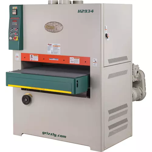

H2934 37" 20 HP 3-Phase Double Head Wide-Belt Sander
Cut sanding time in half with double heads.
The H2934 37" 20 HP 3-Phase Double Head Wide-Belt Sander revolutionizes your workflow by achieving finer finishes in a single pass. This innovative machine boasts two sanding heads, allowing you to simultaneously apply coarse and fine grits for exceptional efficiency.
Sand from coarse to fine grits in one pass, significantly reducing sanding time.
The digital readout displays the table height in increments of 0.005" ensuring precise sanding depth for consistent results.
The variable-speed feed rate is easily adjusted and allows control of the sanding process to match the material and desired finish.
The amperage draw meter, located above the control panel, monitors the amperage draw on the machine while performing sanding operations.
A full range of replacement belts are available.
Upgrade your sanding operation to a double head wide-belt sander!
The H2934 manual was written by our U.S.-based Technical Documentation Department and is packed with useful information. The complete and easy-to-read manual makes it easier to assemble and maintain your sander.
CSA certified
*This machine is prewired for 220V. We can rewire to 440V in a few days’ time for a fee. Please contact Grizzly Technical Support at (570) 546-9663 before placing your order.
- Sanding motor HP: 20 HP, 220V/440V* (prewired 220V), 3-phase, 50.3A/25.1A
- Conveyor motor HP: 1 HP, 3.4A/1.7A
- Table lift motor HP: 1/4 HP, 1.2A/0.6A
- Minimum circuit size: 70A @ 220V, 40A @ 440V
- Maximum board width: 36-1/2"
- Maximum board thickness: 6"
- Minimum board length: 14"
- Minimum board thickness: 3/16"
- Front drum surface speed: 3500 FPM
- Rear drum surface speed: 2600 FPM
- Conveyor speed: 14–60 FPM
- Sanding belt size: 37" x 60"
- Air requirement: 57–75 PSI, 12.3 CFM
- Dust ports: 6 x 5"
- Footprint: 52" x 31"
- Overall dimensions: 59-1/2" W x 54" D x 68" H
- Approx. shipping weight: 2641 lbs.
- Pneumatic belt tensioning
- Adjustable belt oscillation speed
- 4-Column table lifting and lowering system
- Rubber pressure rollers
- Hard rubber infeed drum
- Adjustable graphite platen
- Table height digital readout
- Amp/load meter
- Disc brake for emergency stop
- Variable feed speed
- 1-year limited warranty
