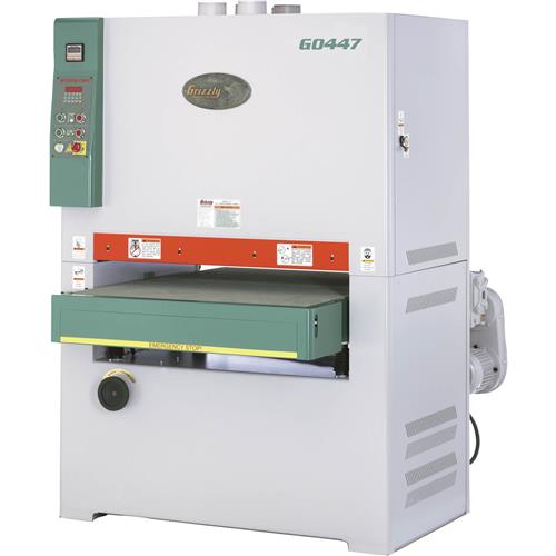

G0447 37" 20 HP 3-Phase Double-Head Wide-Belt Sander
Rarely can a machine claim to cut your sanding time in half.
The G0447 37" 20 HP 3-Phase Double Head Wide-Belt Sander features dual heads enabling them to sand to finer grits in a single pass!
The first belt runs on a single drum and the rear belt runs on a platen system which allows you to adjust the sanding depth.
The sandpaper length needed is 37" wide by 75" long. For a full range of replacement paper for the G0447, shop here.
