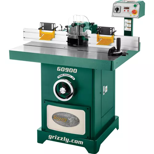

G0900 5 HP Deluxe Spindle Shaper
Boost productivity with this feature-rich Spindle Shaper.
The G0900 5 HP Deluxe Spindle Shaper features an extra-large fence that supplies the support you’ll need for those big jobs.
The independent micro-adjustable fence faces let you dial in cut depths with ultimate precision.
To add to this precision, this shaper includes a digital read-out that displays height in imperial or metric scales.
A clear cutter guard enhances visibility and chip extraction. Four feather boards mount directly to the T-slotted fence and table to help keep workpieces on track.
If you want to mount a power feeder for even better control, this shaper includes pre-drilled holes to accommodate one.
The Deluxe Spindle Shaper provides incredible versatility to handle all your shaping needs with three speeds (5000, 7000, and 10,000 RPM), two spindles (3/4" and 1-1/4") and four different spindle openings from 2-1/2" to 7".

SPECIFICATIONS
  • Motor: 5 HP, 220V, single-phase, 18A
  • Maximum cutter height: 5"
  • Maximum cutter diameter: 7"
  • Spindle diameters: 3/4", 1-1/4"
  • Spindle lengths: 3-7/8", 5-7/8"
  • Spindle speeds: 5000, 7000, 10,000 RPM
  • Spindle travel: 4"
  • Insert openings: 2-1/2", 4-1/8", 5-1/4", 7"
  • Table size: 39-1/4" x 31-1/2"
  • Table counterbore: 5-3/4" dia. x 5/8" deep
  • Floor-to-table height: 35-1/4"
  • Footprint: 23-1/2" x 25-1/2"
  • Overall size: 35-1/2" W x 39-1/2" L x 50-1/2" H
  • Approximate shipping weight: 812 lbs.
FEATURES
  • Dual 4" dust ports
  • DRO for height positioning
  • 4-3/4" aluminum fence with featherboard attachments
  • Rack-and-pinion fence adjustment
  • Fence micro-adjustment knobs
  • 4" of fence travel
  • Power feeder attachment locations (power feeder not included)
  • Quick-release belt tensioner
  • Poly-V belt drive
  • 3/4", 1-1/4" spindles included
  • Fully adjustable clear guard
ACCESSORIES INCLUDED:
  • Open-end wrenches 14 x 17mm, 22 x 24mm
  • Spindle wrench 50mm
  • Hex wrenches 3, 6mm
  • Combo screwdriver #1
  • Starting pin
  • Featherboards for table and fence
