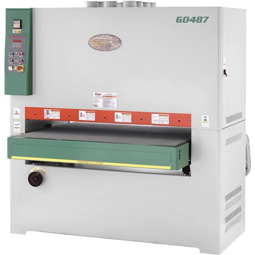

G0487 51" 30 HP 3-Phase Double-Head Wide-Belt Sander
Cut your sanding time in half and sand to finer grits in a single pass!
The first belt of the G0487 51" Double-Head Wide-Belt Sander runs on a single drum and the rear belt runs on a platen system which allows you to adjust the sanding depth.
If you are still sanding through two belt changes using a single-head wide-belt sander, cut your time in half with this double-head sander!
The sanding belts are 51" wide by 75" long. A full range of replacement belts are available.
An efficient and clean dust collection system is essential to the proper function of the sander. Ensuring a healthy work environment is also dependent upon cleaning and maintaining your dust collection system.
The G0487 manual was written by our U.S.-based Technical Documentation Department and is packed with useful information. The complete and easy-to-read manual makes it easier to assemble and maintain your sander.
CSA certified
*This machine is prewired for 220V. We can rewire to 440V in a few days’ time for a fee. Please contact Grizzly Technical Support at (570) 546-9663 before placing your order.
  • Sanding motor HP: 30 HP, 220V/440V* (prewired 240V), 3-phase, 72A/36A
  • Conveyor motor HP: 2 HP, 6A/3A
  • Table lift motor HP: 1/4 HP, 1.2A/0.6A
  • Minimum circuit size: 100A @ 220V, 50A @ 440V
  • Maximum board width: 51"
  • Maximum board thickness: 6"
  • Minimum board length: 11"
  • Minimum board thickness: 3/16"
  • Front drum surface speed: 3500 FPM
  • Rear drum surface speed: 2600 FPM
  • Conveyor speed: 14–60 FPM
  • Sanding belt size: 51" x 75"
  • Air requirement: 75 PSI
  • Dust ports: 10 x 4"
  • Footprint: 68" x 31"
  • Overall dimensions: 71" W x 59-1/2" D x 79" H
  • Approximate shipping weight: 3880 lbs.
  • Rubber pressure rollers
  • Hard rubber infeed drum
  • Adjustable graphite platen
  • Digital encoder depth control
  • Amp/load meter
  • Disc brake for emergency stop
  • Variable-feed speed
  • 1-year limited warranty
