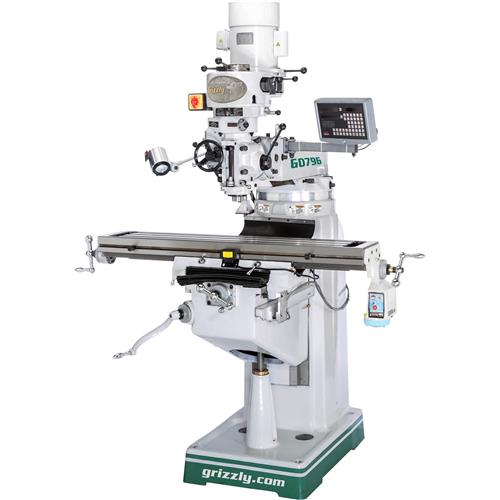

G0796 9" x 49" 3 HP Vertical Mill with Power Feed and DRO
Amazing features at an affordable price.
The G0796 9" x 49" Vertical Mill with power feed and DRO is a full featured mill built for those that only have single-phase power. This machine has a 2-axis DRO to ensure exact table position at all times.
With the 9" x 49" table, you can set up a rotary table or another fixture on one side without having to remove your vise on the other. Additionally, the table has a built-in longitudinal power feed!
The bed of the lathe is constructed with Meehanite® castings that are hardened and precision-ground in the traditional three V-way prismatic design.
The one-shot pump action lubricates the X-, Y- and Z-axis table ways. The halogen work light provides direct light on your workpiece for improved visibility.
Like all Grizzly vertical milling machines, the G0796 comes with a 1-year warranty which covers parts and assures the unit is free from factory defects.
The G0796 manual was written by our U.S.-based Technical Documentation Department and is packed with useful information. The complete and easy-to-read manual makes it easier to assemble and maintain your mill.
The Grizzly Customer Service and Technical Support Teams are U.S.-based. Parts for the mill are available online and shipped from the Grizzly parts warehouse in Springfield, MO.
- Motor: 3HP, 220V, single-phase, 19.5A
- Spindle taper: R-8
- Spindle travel: 5"
- Spindle speeds: 8, 80–2720 RPM
- Head ram travel: 12"
- Head tilt: 90° left/right, 45° front/back
- Turret/column swivel: 360°
- Maximum distance spindle to table: 15-7/8"
- Table travel (longitudinal): 28"
- Table travel (cross): 12"
- Table travel (vertical): 16"
- Table size: 9" x 49"
- T-slots: 3 @ 2-1/2" centers, 5/8" wide
- Base footprint: 41" x 27"
- Overall dimensions: 83" W x 62" D x 84" H
- Approximate shipping weight: 2580 lbs.
- Longitudinal power feed
- 2-Axis DRO
- Meehanite® castings
- Chrome-plated, precision-ground quill
- One-shot pump lubrication
- Auto stop with micro-adjustable stop
- Auto downfeed
- R-8 Spindle
- X- and Y-axis covers
- Hardened and ground table surface
- Forward and reverse spindle switch
- Halogen work light
- Includes service tools and toolbox
