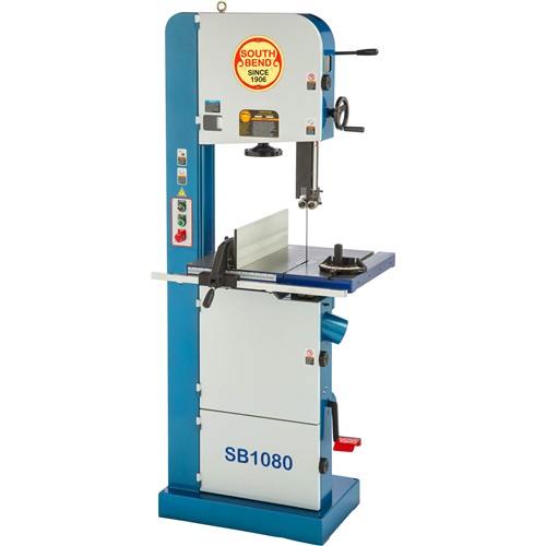

SB1080 South Bend 16" 3 HP Heavy-Duty Bandsaw
Ultimate power for the industrial woodworking shop.
The South Bend SB1080 16" 3 HP resaw bandsaw accurately powers through hardwoods up to 14" thick with rack-and-pinion dual ball bearing guides and a precision-ground cast-iron fence with a dual-position 6" tall resaw attachment.
This could be the sturdiest machine in your shop. Its stout steel frame, computer-balanced cast-iron wheels, and extra-large 25-5/8" x 20-7/8" x 2" thick precision-ground cast-iron table and cast-iron trunnions all work together to minimize vibration and lead to greater accuracy and higher-quality work.
The table tilting mechanism is the strongest in the industry, allowing you to put the heaviest loads on the table without losing squareness.
If absolute best results are the only option, this is the bandsaw for you.
Other high-end features such as dual dust ports, quick-release blade tension, and built-in storage, to name a few, are what take the SB1080 from a great saw to an outstanding piece of machinery.
For a full range replacement and resaw blades for the SB1080, shop here.
The SB1080 bandsaw is built to true South Bend high-precision industrial standards and comes with a 2-year warranty.
The SB1080 manual was written by our U.S. based Technical Documentation Department and is packed with useful information.
The South Bend Customer Service and Technical Support Teams are U.S.-based. Parts are available online and shipped from the South Bend parts warehouse in Springfield, MO.
  • Motor: 3 HP, 230V, single-phase, 14A
  • Throat (max. width left of blade): 15-3/4"
  • Resaw capacity: 14"
  • Table size: 20-7/8" x 25-5/8"
  • Table tilt: 5° left, 45° right
  • Floor-to-table height: 41"
  • Blade guides: Ball-bearing, upper & lower with thrust bearings
  • Blade size: 131-1/2" (1/8"–1" wide)
  • Blade speed: 3500 FPM
  • Dimensions: 33" W x 36" D x 79-1/2" H
  • Footprint: 27" x 18"
  • Approximate shipping weight: 558 lbs.
  • Precision-ground cast-iron table with cast-iron trunnion
  • Cast-iron fence with two-position extruded aluminum resaw fence
  • Computer-balanced cast-iron wheels
  • Built-in blade and tool storage
  • Foot-operated brake system
  • Quick-change blade release/tensioner
  • US based customer service and technical support
