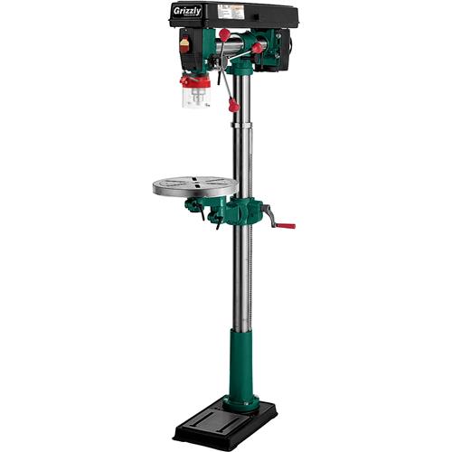

G7946 34" Floor Radial Drill Press
A truly versatile floor drill press thanks to the angled drilling capacity.
The G7946 34" Floor Radial Drill Press boasts a 1/2 HP motor that smoothly powers the five spindle speeds ranging from 550 to 3000 RPM.
The headstock can be tilted 45° left, 90° right, and slid forward or backward over the column allowing you full adjustability.
To make sure that you get the best use of the table, the drill press features rack-and-pinion elevation controls—adjustable 24-1/2" vertically, 90° tilt (left and right) and is capable of 360° rotation around the column.
The G7946 can easily drill holes through plastic, fiberglass, and composites and has a maximum capacity to drill through a half inch of steel without bogging down.
The JT33 keyed drill chuck is fitted to the JT33 spindle taper and offers up to 3-1/4" of travel. The chuck accepts drill bits from 1/16"–5/8". You can set the adjustable threaded depth stop for predetermined and repeatable drilling.

  • Motor: 1/2 HP, single-phase, 120V, 4.7A
  • Swing: 34"
  • Drill chuck: 1/16"–5/8", JT33
  • Drilling capacity: 1/2" mild steel
  • Spindle travel: 3-1/4"
  • Spindle speeds: 5, 550–3000 RPM
  • Column diameter: 2.79"
  • Table size: 12-3/16" diameter
  • Table T-slots: 6 @5/8"
  • Table swing: 360°
  • Table tilts: 90° L/R
  • Head tilt: 90° L, 45° R
  • Footprint: 11" W x 18" L
  • Overall size: 14" W x 32" D x 64-1/2" H
  • Approximate shipping weight: 170 lbs.
  • Threaded depth stop
  • Crank handle operated rack-and-pinion vertical table movement
  • Table has lock levers
  • Radial design allows angle drilling
  • Cushioned grip quill handles
