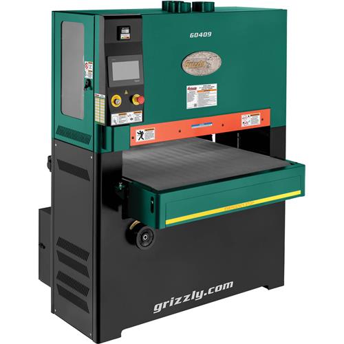

G0409 37" 10 HP Extreme Series Wide-Belt Sander
Upgrade your woodworking shop with this wide-belt sander designed to efficiently process large panels.
Get your professional shop up to full speed by adding this wide-belt sander to your equipment lineup.
Fitted with a high-powered 10 HP motor, the sander turns out top quality, consistently smooth workpieces so you can meet every deadline.
Special options on this 37" wide-belt sander include a platen for uniform results, user-friendly touch-screen controls, thickness sensor, clear side window, and interior lighting.
This sander is equipped to boost your daily shop efficiency, whether your focus is achieving a high-quality finish on custom furniture, sanding architectural millwork, or preparing wide planks for flooring.
FEATURES & BENEFITS:
  • A platen offers even pressure for fine sanding with a smooth finish
  • Touch-screen controls for motors, sanding drum, conveyor, and table elevation
  • Material thickness sensor automatically adjusts the table to the thickness of your workpiece
  • Plexiglass side window and interior lights for easy viewing of sanding belt tracking
  • Variable-speed feed conveyor for adaptability and optimal sanding results
  • Pneumatic belt tracking and tensioning to maintain the perfect pressure for accurate sanding
  • Amp/load meter to prevent excessive loads while maximizing machine capacity
  • Built-in air regulator/water separator to protect pneumatic components
  • Rubber infeed and outfeed pressure rollers prevent uneven sanding and dampen vibration
  • Disc brake, emergency stop bar, and stop switch for optimal safety
  • Main motor: 10 HP, 220V, single-phase, 50A
  • Conveyor feed motor: 1 HP, 7A
  • Table elevation motor: 1/3 HP, 3A
  • Maximum board width: 36-1/2"
  • Maximum board thickness: 6"
  • Minimum board length: 14"
  • Minimum board thickness: 1/8"
  • Conveyor speed: 15-49 FPM
  • Sanding belt speed: 2565 FPM
  • Sanding belt size: 37" x 60"
  • Sanding belt oscillations: 35-40 OPM
  • Platen type: 2-1/4" x 37-3/4" Adjustable graphite pad
  • Air requirement: 75 PSI
  • Footprint: 51" x 19"
  • Overall dimensions: 53" W x 50" D x 66" H
  • Approximate shipping weight: 1808 lbs.
Simplify high-volume sanding by adding this feature-packed 37" 10 HP wide-belt sander to your shop today.
